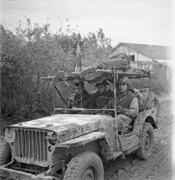

Some photos from Library and Archives Canada showing a range of census numbers used on Canadian jeeps:
(left to right)
Photo 1 (CM 4230213) - Troopers of the Three Rivers Regiment in a jeep, England, 22 July 1942.
Credit: Lieut. C.E. Nye/Department of National Defence/Library and Archives Canada/PA-213504
Photo 2 (CM 116 . . .?) - A jeep ambulance of the Royal Canadian Army Medical Corps (R.C.A.M.C.) bringing in two wounded Canadian soldiers on the Moro River front south of San Leonardo di Ortona, Italy, 10 December 1943
Credit: Lieut. Frederick G. Whitcombe/Department of National Defence/Library and Archives Canada/PA-180097
Photo 3 (CM 4233488) - An ambulance jeep of the Royal Canadian Army Medical Corps (R.C.A.M.C.), Vaucelles, France, 20 July 1944
Credit: Lieut. Ken Bell/Department of National Defence/Library and Archives Canada/PA-129031
Photo 4 (M 5826948) - Two unidentified corporals of the 2nd Provost Company, Canadian Provost Corps (C.P.C.), exchanging notes on the hood of their jeep in the Reichswald, Germany, 20 March 1945.
Credit: Lieut. Ken Bell/Department of National Defence/Library and Archives Canada/PA-140123
Photo 5 (CM 4232803) - Personnel of the British Columbia Regiment with a jeep, near Brasschaet, Belgium, 14 October 1944.
Credit: Lieut. Michael M. Dean/Department of National Defence/Library and Archives Canada/PA-151371
Photo 1 - a213504-v6.jpg   Photo 2 - a180097-v6.jpg   Photo 3 - a129031-v6.jpg   Photo 4 - a140123-v6.jpg   Photo 5 - a151371-v6.jpg

According to this list the number posted at the beginning of the thread (CM4402587) would not be realistic. The number posted by Eric (CM4421919) would also be outside the range but may have been a borrowed/rented Jeep from the Brits to which the "C" prefix was incorrectly added. The list of numbers supplied by Mark are all correct - taking into account the Mxxxx vehicle which may be a Brit jeep in Canadian service. The great photo supplied by Bill (CM5584352) again shows a jeep outside of the range but the date of the photo (and of Mark's "M" jeep) both ante-date my list. In reviewing almost 300 jeep photos in my files I found several in the CM424xxxxx range which are definitly Canadian, including one with General Crerar at the wheel.
