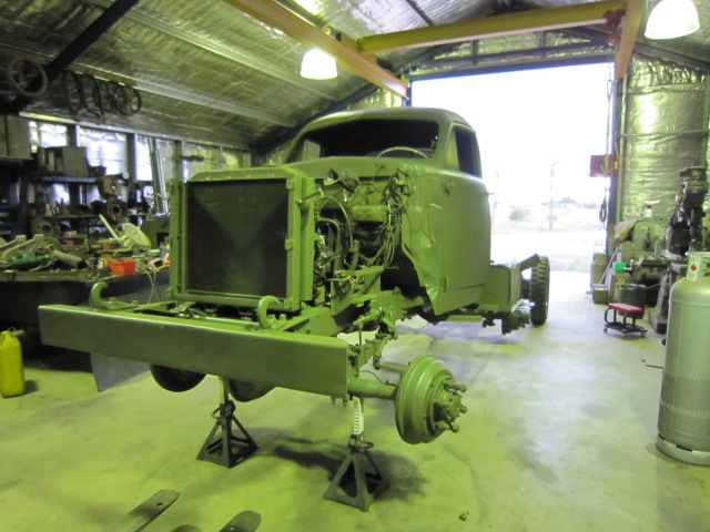

Hi everyone, I know I should have started photo's before, but better late than never. My progress to date!
Colin.

Ganmain Tony's Avatar
Join Date: Jul 2009
Posts: 1,246
Default Fantastic Colin
Another superb looking job Colin. How are you doing the painting?
Full run down please, set up, types of paint etc. I want to start on my little F15 soon. Keen to hear how the pro's do it...

Hi Tony, if I can find a pro I'll ask them how they do it, but I use a normal spray gun. The paint I use is PROTEC 503 equipment enamel, khaki green No3 its the best paint I have found and very quick drying and about $35 for 4 litres and thinning out around 20-25%. Don't forget a couple of 303 holes for visual effect
Hi Dave, you would be right about the colours. After sanding, you can see the black chassis and original green on the cab but I'm sticking with the good old KG N03.
