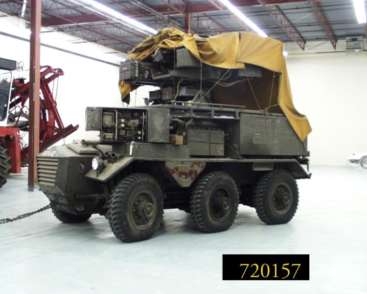

So the nugget of information that the Saracen was alleged to to be at the Canadian Museum of Science and Technology (CMST) in their reserve collection has rattled around my head for a good number of years now.
I no longer live in Ottawa and trips to that town are less frequent and making appointments and travelling for a specific purpose gets awkward so I have not ferreted the vehicle out, until recently.
I was waiting for a supplier to perform a task and I was spinning my wheels, so I dropped by the CMST admin office and defeated the impervious exterior and the no doorbell ploy and made multiple phone calls on the provided office phone in the lobby (who can afford a reception desk these days) until I reached a human and pleaded my case.
Human first person interaction was quickly achieved with Gordon Perrault who is the Director of Conservation and Collection Service. He was very pleasant and despite my lack of an appointment was very willing to help me as he realised that being from out of town and my employment vagaries hindered that.
He arranged for staff member Phillip Craig, an Artifact Handler to escort me through the reserve collection and show me the vehicle, which while he wasn't sure about Phillip reassured him they very much had and he knew about it.
I then went to the storage facility and met with Phillip who was a very pleasant and knowledgeable gentleman, not surprising as he shares my last name.
The CMST is in a state of change and rebirth as the new museum has recently opened and the reserve collection will also move there into a new storage facility in the coming months / year.
We passed many significant artifact as we walked and squeezed past items under wraps I recognised many from visits many years ago. He switched lights on as we went deeper into the depths. Finally we arrived at a very dusty lump under plastic. It was the Saracen.
I was giddy as the proverbial school boy and started discussing and explaining the base vehicle as Phillip wrestled with the huge sheet of plastic and the the cover under that. Obviously it was fairly hemmed in and photos were not the best. However Phillip said he had at least one picture in the online museum catalogue but there may also be other shots on the museums own data base he could let me have for use on the forum and elsewhere with credit.
Once back in his office he found the photos and emailed them to me.
These pictures were taken during a shuffle a few years ago and the vehicle was not running. So, with credit to the Canadian Museum of Science and Technology and with my most sincere that to Gordon Perrault and Phillip Craig, here is the radar Saracen.
CMST Saracen 01 1972.0157.001.ac.cs.jpg   CMst saracen 02 1972.0157.001.ab.cs.jpg   CMST SARACEN 04  1972.0157.001.ad.cs.jpg

The big number on the bottom of the images is the museum asset number which starts with the year of acquisition, formally now it is 1970.0157 but in those days photos didn't have the first two digits of the year, now they do.
My impression is that this was a very overloaded and cramped vehicle with the system mounted on top and all the technical bits stuffed inside and in the boxes on the sides.
To say overloaded and cumbersome would be accurate. What I did note was not one trace of any kind of CFR and the clear evidence of the Vehicle Registration Number from the UK MOD, 80 BA 52 on the nose and on the data plate.
CMST saracen 05 1972.0157.001.ae.cs.jpg   CMST SARACEN  03 1972.0157.001.aa.cs.jpg

The pictures of the Saracen at Cohens and then later at Prefair are not very clear but Ed Storey had noted that it was 30 BA 07 and I have confirmed that through another means. Add to that the clearly visible 80 BA 52 for the one at CMST.
I spent some time once I got home cruising the net with Google and came up a winner unexpectedly.
The National Research Council of Canada has images online. Here are 80 BA 52 the one in CMST
SARACEN RADAR NRC05.jpg   SARACEN RADAR NRC06.jpg   SARACEN RADAR NRC03.jpg   SARACEN RADAR NRC04.jpg

The data plate for the base vehicle and that for the radar itself were both found in my visit and here they are.
My suspicion is that the second vehicle 30 BA 07 had the radar removed and it was put on to an M113 and now I need the picture I cant find it again, go figure. I would speculate that the cost of doing this was big and only one was done and then something else came along as the new flavour of the time and things were shelved. It is pure speculation at this time.

This Counter-Mortar Radar equipment was developed for the Canadian Army by the National Research Council and was production-engineered and produced by Raytheon Canada Limited. The AN/MPQ-501 equipment was a mobile microwave radar for the field forces designed to locate the source of hostile mortars, rockets, and other high-angle artillery. It also had demonstrated an ability to locate field artillery and provide rapid registration of counter gunfire. Designed for mounting on an armoured vehicle of the M113 and other types, the radar had a high degree of mobility, enabling it to move rapidly to site, perform its function, and then quickly move away. The air transportability of this equipment, when mounted on such an armoured vehicle, had been demonstrated by the RCAF when they transported tactical vehicular installations of this radar equipment non-stop to Europe from the RCAF Downsview airport in a C130 Hercules.
The AN/ MPQ-501 would perform the following functions:-
(a) Accurate location of hostile mortars and other high-angle artillery.
(b) Registration and adjustment of divisional artillery.
(c) Location of hostile ballistic rocket positions.
(d) Combat area surveillance.
(e) Survey of own and other positions.
Outstanding features of Radar AN/ MPQ-501
• 5 minutes into action and 2 minutes out of action-day or night.
• One man setup and operation without exposure.
• Fully automatic antenna levelling.
• Automatic loading and stowage.
• Automatic time insertion, beam centering and shifting.
• First round location.
• Simultaneous fire capabilities.
• True presentation of signal pairs to avoid confusion.
• Single beam extrapolation provided.
• Locations in both Cartesian and polar co-ordinates.
• Fall of shot corrections direct on counters.
• Fast automatic computer clearing between rounds.
• No trailer, no field cables-self-contained and powered on single armoured
vehicle allowing maximum mobility.
• Fully air-conditioned including N.B.C. protection.
• Frequency, power, noise figure and tuning monitored.
Raytheon Canada Limited was equipped to design, develop, and manufacture
high quality radar systems such as the AN/ MPQ-501, as well as communications radar equipment for airport and airways surveillance.
