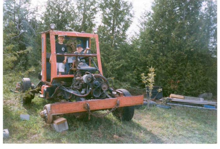

Default Bill's CMP Snow Plough
Notice anything out of the ordinary with this "conversion"?
Photo 1 - The CMP as Bill bought it
Photo 2 - Stripped down
Photo 3 - Framing
Photo 4 - Cab
Photo 5 - Finished product
Thanks to Bill for providing these photos
