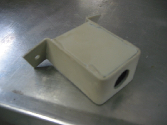

Here is some pictures of the park brake shield and when I get a chance I will try to get some dimensions written up. Lynn the rubber seal you could get from Brian Asbury and you can email him at: brian.asbury@sympatico.ca with I believe part # TL3615.

I drew up the dimensions of the park brake cover so I hope they are legible. It is a very difficult item to try and draw up the measurements on.

I have talked with Midwest Military and when I get home in May, I am going to send him my original. He will manufacture copies for the market. His repros are quite good, so if you can wait, you can get the next best thing to NOS.

Dave thanks for the measurements i will try and cobble something up, what thickness is the steel it looks circa 16 Gauge but its a guess, it looks to have been made in a press ?

And more painting
ID:	43880   Click image for larger version
ID:	43881   Click image for larger version
ID:	43882   Click image for larger version
  #59
Old 18-09-11, 06:39
Dave Good
Join Date: Dec 2003
Posts: 684
The suspension swing arm, the bushing and one of the good and poor shape swing arm pin
ID:	43884   Click image for larger version
ID:	43885   Click image for larger version
ID:	43886   Click image for larger version
ID:	43887   Click image for larger version
