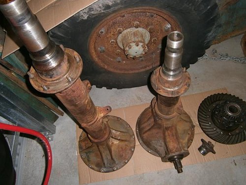

Work on the rear axle continues.

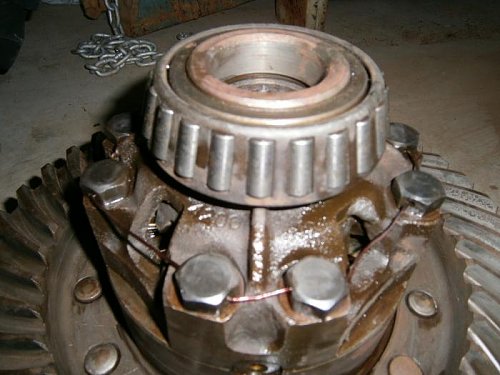

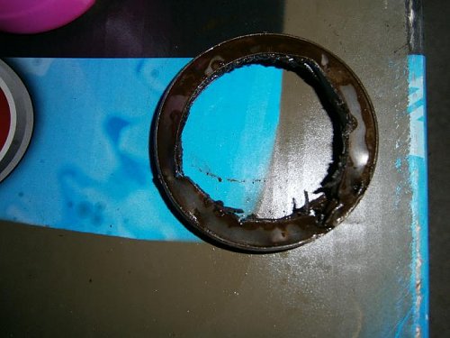

Diff case opened, the cleaning & assessment has began. Insides of casing were OK, but both the seals and bearing cones are not & will need replacing. I have ordered the seals from Ross Prince but feel I only asked for the fibre ring and will also need the metal part too.

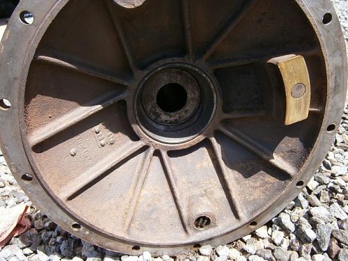

The pinion seal parts are knackered also. Once again, I will have to revise my parts order. As you see, I had to fight the metal bit to get it out.

Didn't find any evidence of what had damaged the shorter axle end, and the differential itself seems to be OK. One of the bearings has some rust pitting on a number of the rollers and will need replacing.

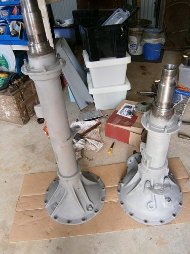

Brake backing plates have been blasted and painted. This one was assembled with the old cylinder, as a test only. All new hardware bought. Some of the original bolts & nuts were a bit chewed by rust. The 7/16 castle nuts which hold the brake backing plate to the rear axle were a shock as far as price goes. Originally quoted at more that $3.00 EACH!! Stated to be expensive due to their 'rarity'. Finally bought 24 of them at less than $1 each. Still outragously dear.

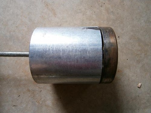

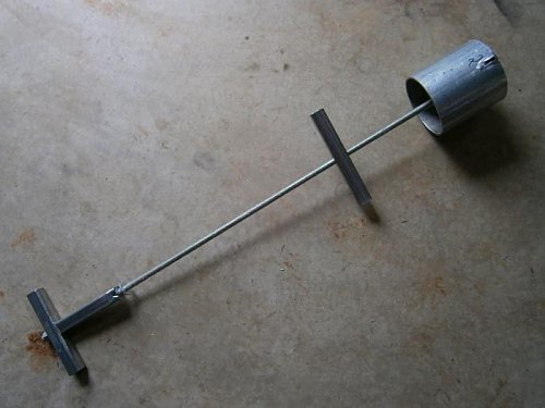

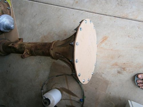

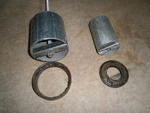

All bearings & grease/oil seals now removed from diff housing. I followed instructions of fellow MLU'er to run a bead of arc weld around inside of bearing cup. Once this was done, the cup was VERY easy to remove. Axle seals popped out with pushing for hub end with tube steel. Rear axle housing will go to sandblasting this week, once I make MDF plates to cover where they join together. I want to keep them seperate for the blasting, mainly because I can't lift the thing if I put the halves back together.

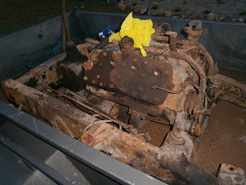

Also returned home with a Sidevalve V8 and gearbox, for rebuilding, both of which were still attached to about 5ft of front chassis. Moving them around will be much easier once I put wheels under it.
