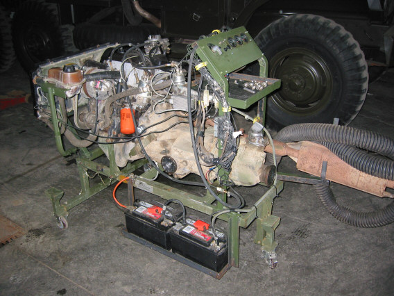

If you need the factory timing specs you remove the rubber plug on the drivers side on top of the bellhousing and line up the 0 on the flywheel to the arrow tab just inside of the hole.
I was lucky to be able to pick up the factory Iltis power pack stand and ad some bolt on brackets to make a great test stand for engines and all of the bolt on components like alt, starter, dist, TCI boxes.I used parts of a factory wiring harness to make connections a lot easier. see pics.
175-7583_IMG.JPG   175-7584_IMG.JPG   175-7586_IMG.JPG   175-7593_IMG.JPG   175-7579_IMG.jpg
