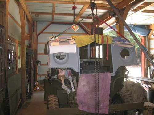

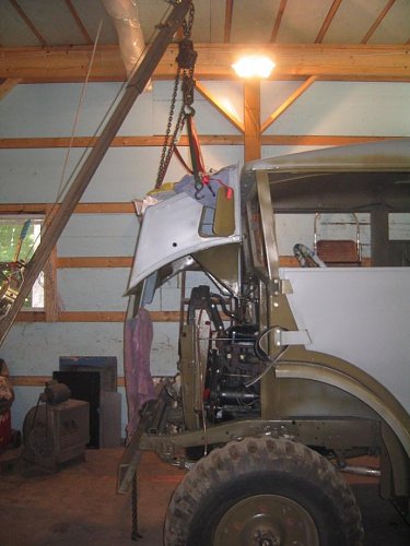

Default Glad you asked the question about slipping engines in
Hi Bob
Glad you asked the question when you did, because I had not removed any of the rigging yet, so it was easy to just take more pictures to show the detail. I'll get them organized and posted.
Whats funny is that get the engine in is now the easier part of the job, what is still time consuming is getting everything hooked up that is taking time. Things like replacing the flex fuel line between the body and the engine fuel pump. Have to get a new one because the old one didn't like the ethanol.

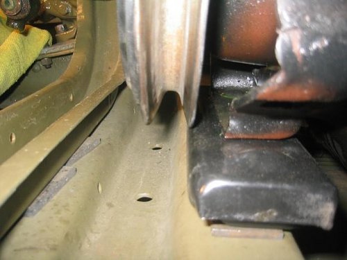

Default Started Engine in HUP today
Hi All
Well after a speedy installation of the engine it took me 2 days to get it all connected up. Actually it took 4 hours to hook everything up and day and a half to find where I had put all the parts.
When I turn on the ignition and hit the starter the engine fired right up. But there was a horrible grinding noise from the front of the engine and no oil pressure. Turn off the engine and went looking for source of the problems. Lack of oil pressure was easy to find, puddle of oil on floor right below the oil pressure line which wasn't connected.
Fixed that and started searching for source of the noise, loosened the generator and spun fan to check the water pump and make sure fan was not hitting any thing, no problem. Spun the generator no noise. So I left the fan belt of and restarted the engine. Grinding sound still there but was easy to localize. Anyone else want to guess the source of the problem?
Name:	2012 HUP 18-19 June 012.jpg
Yes I installed the front engine mount the wrong way around. Stick that one in the back of your head when your installing a Chevy engine. It is a real pain to fix this little problem about 3 hours to disconnect the various parts to lift the engine up the couple of inches necessary to remove the mount and turn it around and then put all the parts back.

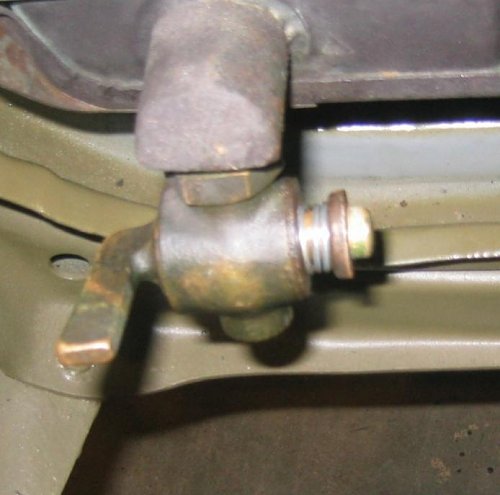

I was able to replace the spring on the radiator drain cock.
Name:	2012 HUP 18-19 June 011.jpg
Once that was all done restarted the engine and let it run nice and quiet oil pressure OK and the temperature came up to 160 F which is the thermostat on installed. In re-plumbing to install the steam relief tube, valve and the temperature gauge I discovered something I had never noticed.
Name:	2012 HUP 18-19 June 002.jpg
The valve has a small hole drilled in it to allow a small amount always coolant to flow past the sensor.

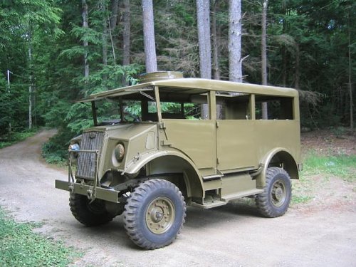

Default It lives

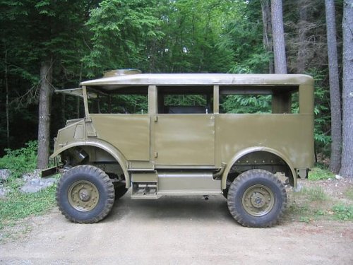

Yes, today the HUP did move out of the shop under its own power.
It was a short drive but a big step forward. Link to video http://canadianmilitarypattern.com/R...021%202012.wmv
As to Mikes question about hopping up the 216, only with the other trucks. My HUP was very original and complete when I got it years ago and as much as possible I'm keeping it stock with as many of its original parts, nuts, bolts, as I can keep reusing.

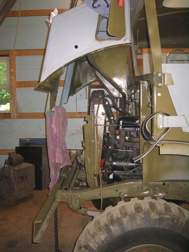

Default Nose and Rear Axles
Hi
Working on an CMP is just so much more fun when you can actually see the progress. But the restoration lesson for the day is sort and label the parts and only have one storage area for the parts. Still wasting time looking for parts I know just seen. Same game as always putting the tools back in the tool box.
Today's goal was to get the nose on and the rear axle shafts in place. As you can see from the photos hoisting the nose is a mater of couple of cargo straps two hooked in the vents and centered to the hoist and one to the front of the nose so that the nose hangs horizontal right to left and vertical along the back. (one caution loop one of the straps around the hoist hook so that the load of the nose can not slip to one side or the other.)
Name:	MLU 2012 HUP 22 June 001.jpg
ID:	50057 Click image for larger version
Name:	MLU 2012 HUP 22 June 002.jpg
ID:	50058 Click image for larger version
Name:	MLU 2012 HUP 22 June 003.jpg
ID:	50059 Click image for larger version
Name:	MLU 2012 HUP 22 June 004.jpg
One tip remove the brake peddle so that the curve of the wheel well can come straight down. Once the nose is bolted it you can slip the peddle back on easily.

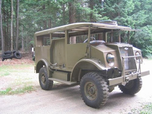

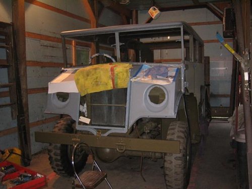

Default Painting work continues
With virtually all the parts now bolted back in place the finial coat of paint starts to go on. Well almost.
Hi All
With virtually all the parts now bolted back in place the final coat of paint starts to go on, well almost. In an homage to Gary Baths question about painting and the responses http://www.mapleleafup.net/forums/sh...light=painting what was to have been the top coat didn't go one as planned. So much for painting technique from memory as to and when all else fails go back and read the manual.
Paint came out uneven with a lot of bits of paint drying before they hit the body. HUP looks a little like a zebra in with gloss and flat pattern.
Got out the Dupont painting shop manual matched up the pictures of the paint flaws and looked at the possible causes. The list of problems:
Paint to thick/runs- correct viscosity to proper 18-20 sec cup test
Wrong air pressure/poor paint spray pattern - increase pressure to the suggested 50-65 psi (syphon type gun)
Speckles and narrow gun patter - Dirty gun (yup this is the real killer) disassembled the gun soaked the whole thing in cleaner and clean each part of the paint path with soft brushes until all the old paint was gone. The gun worked fine for painting individual parts with just running some paint thinner through it after each use but for the overall painting it just didn't want to work right.
Practiced with some old paint (not the Dupont Centari specially mixed to match original HUP color). Painted some practice panels and Jerry Cans and the paint went on like a charm. Tomorrow I'll lightly wet sand the HUP to clean up the imperfections and see if I can lay down a smooth flat top coat.
July 2012
Name:	MLU 2012 HUP July 012.jpg
ID:	50332 Click image for larger version
Name:	MLU 2012 HUP July 016.jpg
ID:	50333 Click image for larger version
Name:	MLU 2012 HUP July 017.jpg
