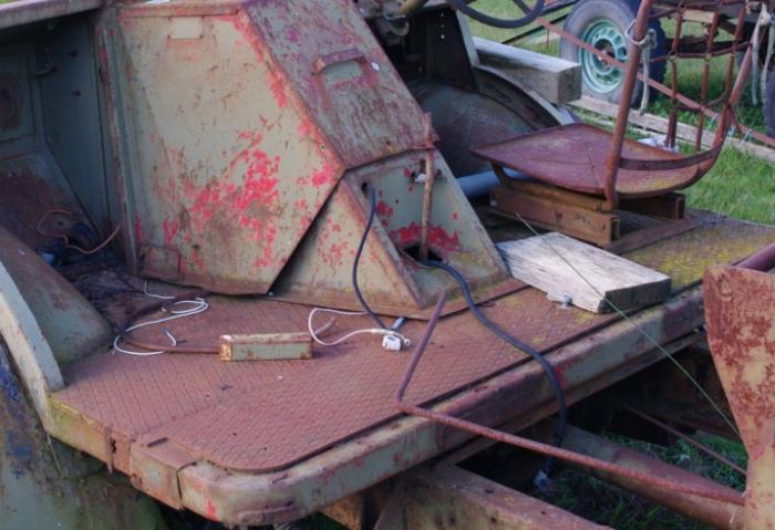

After a far too long hiatus this project is again underway. First job today (after building and planting out the vegie garden) was to rid the carport of the interloping Suzuki Vitara (and listed it on ebay in case anyone is looking for one), and move the FGT into position for some preparatory work to start before moving it to Euan's workshop where the rear body will be attached.
As far as can be ascertained these FGTs were built in 1942, so it being her 70th birthday it is only fit and proper to give her some attention.
One of the first jobs will be to unseize the reactionary linkage for the brakes. I did have the whole thing working beautifully with a new booster, but when the brakes are applied the pedal stays determinedly in the down position and having just disconnected the booster it appears the reactionary linkage has frozen. I resleeved the master and wheel cylinders some time ago.
She's much happier here out of the weather!

Another step on the long road to restoration for the FGT when I removed the 2C1 box which had been sitting on the rear of the subframe (to keep it off the ground). It made the FGT into some sort of oversize pickup.
It was a case of undo the temporary U-bolts, lift it up, drive out and back in a trailer, ready for it's trip to Ganmain Tony to try out his welding skills.
I must admit, this is a very gnarly CMP!
The bits of primer are where I had to heat and use multigrips to remove sheared off bolts on the front shell.
