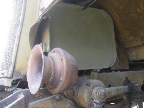

The horn is attached to the bracket that holds the front part of radiator overflow tank. Or at least that's where I have seen several attached. There is a small horn bracket which goes on horn itself, and this small piece is what is connected to the overflow tank front bracket.

Robert, here are several images I have found, showing the horn and/or where it is attached.

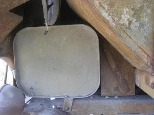

This is a shot of the overflow tank itself. Horn attaches to the front vertical strap.

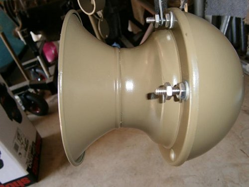

This is my horn. I believe it is correct for a Ford Cab 13.

Name:	Horn detail closeup.jpg
This should have all the detail you need. including how the bracket between horn & overflow tank looks. I got mine from ebay some months ago.
