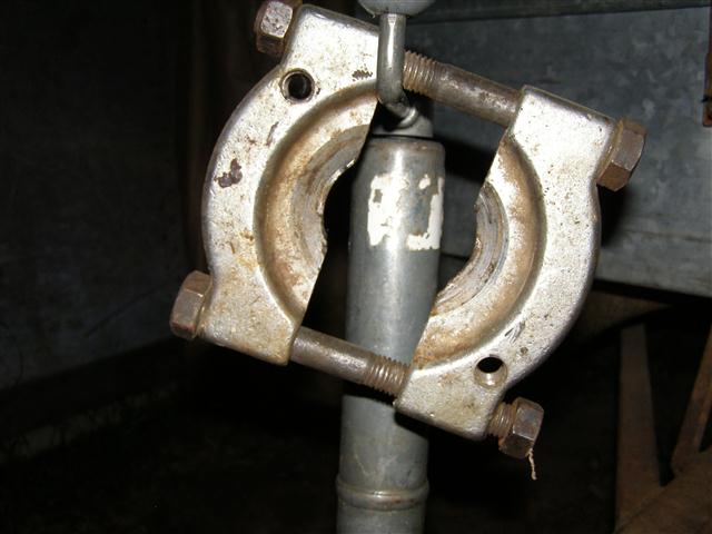

Default Puller
Alex you need this atachment for a hydraulic puller for the best chance of sucess. You could try a hose clamp around the botom of the fingers it may work.

Default That's the tool to use.
You need that two piece gear puller to have a good purchase with the fingers of the puller.
I tried that...... I was getting some serious tention on the puller..... and even greased the acme tread to be sure it would not gall up on me..... no luck !!!!!
I am sure heat woulhave made the difference.
Why are they so hard to remove...??
