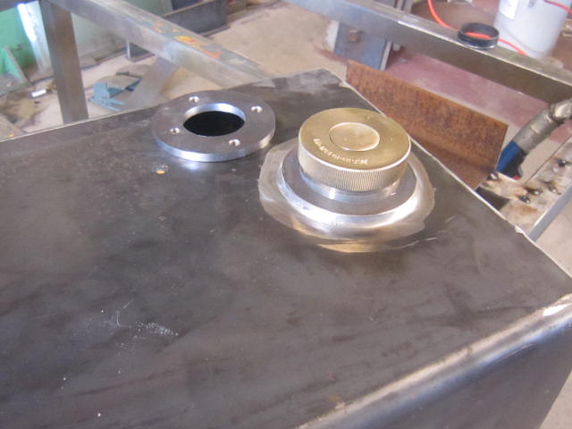

Fuel tanks finished with the help of my little helper Andrew. He's learning well!

fittings all done and a quick pressure and the old soapy water test diligently performed again by the budding apprentice (non paid of course) Andrew.
Just a quick grind and then paint.
