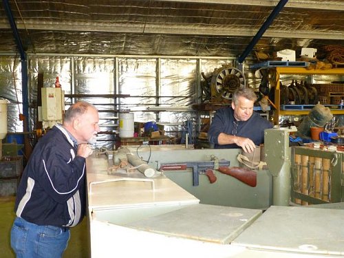

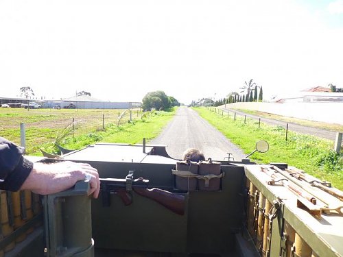

Dad and i had a great time at Colins today and typical of his hospitality he asked if we would like a spin in his brengun carrier.(we said no but Colin made us) Now Colins driveway is longer than most streets and i could not believe the speed we were going, enough to make the eyes water. So thanks mate for having us and showing your impressive collection of militaria.

Shane, you were lucky to get a ride in a very unique vehicle. 6901 is Colin's recreation of a 3" mortar carrier. All that were built went to China during WWII and none are known to have survived. We owe a debt of gratitude to Colin for recreating a part of Australia's military history.
Regards Rick

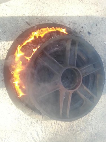

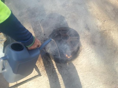

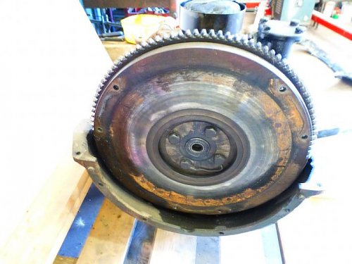

Hi all.
Well this was four hours of fun, it was a mess but Coppers Ale made the time just fly bye.

Keith told me to use petrol to clean and it worked great. Also took it for a drive to Happy Car Wash the owner was not to happy about me cleaning the sump in a car wash but i had just finished. So happy days for me and the sump.

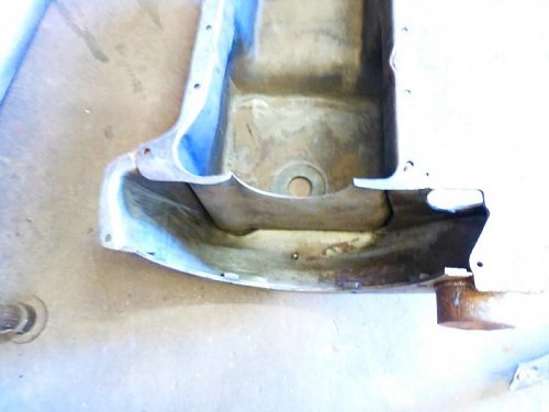

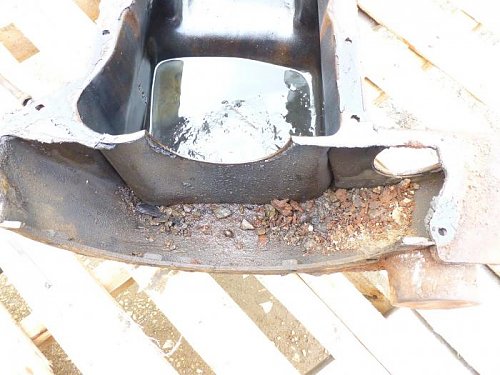

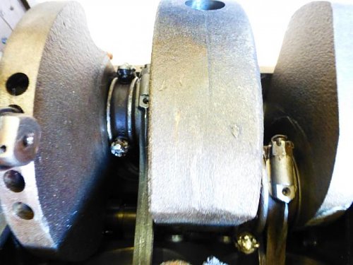

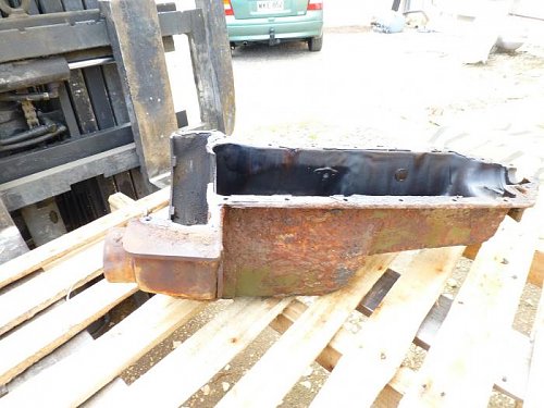

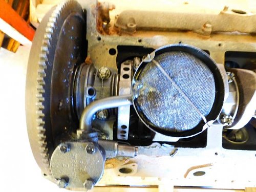

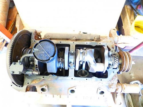

Hi lads

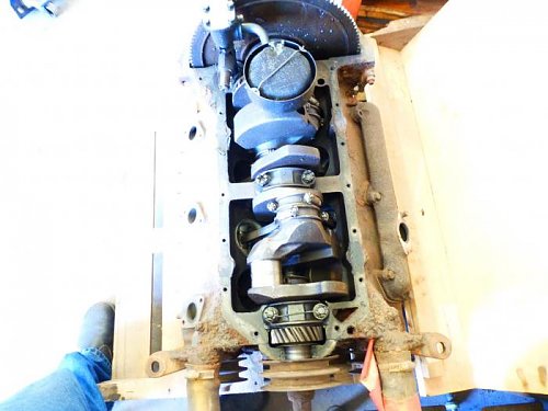

Some shots of the motor, still after a radiator if anyone has one for sale.
ID:	59473 Click image for larger version
ID:	59474 Click image for larger version
ID:	59475 Click image for larger version
ID:	59476 Click image for larger version
Also need a army marked fire extinguisher and fire extinguisher bracket. Cheers Shane

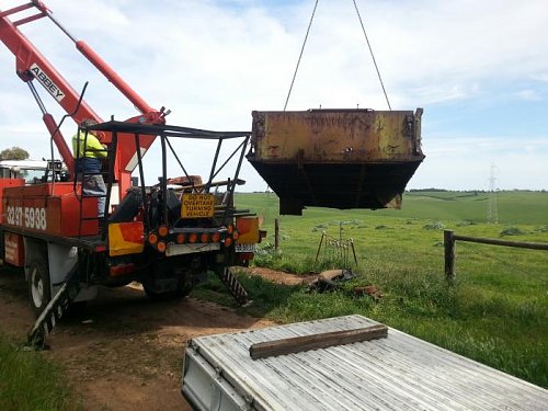

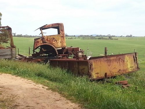

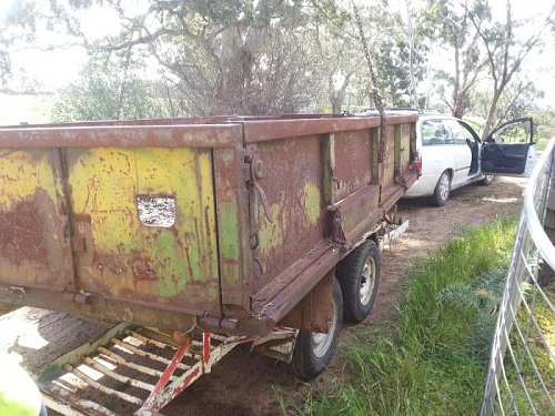

Well its been a long day but i finally got my tray. A big thanks to Hugh for selling and helping me load the very very heavy bit of kit. Nice to know it was made by Holdens you can see the Holden plant from Hugh's place. If anyone has the correct badge that would have been on the tray please let me know. The current condition needs attention but im going to learn from a man that could fix it in his sleep, its the last thing on the list to do so it will be a long time until you see her restored.On the side of the tray it reads.....

The tray was way to heavy for my truck so it went on a car trailer.

The tile truck wasn't quite up to the job I see... love the "crane" too.

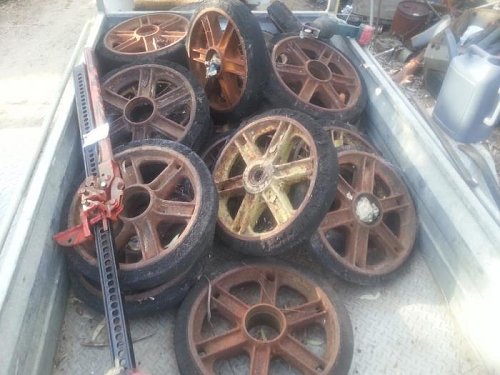

Had a blast at Hugh's place getting the tray for the cab 12. However at the end of the day Hugh and i were taking rubber off the old bren wheels which for me was a blast, it takes around 30 min for each wheel.

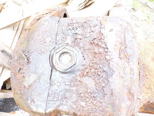

Would just like to know what the best thing is to flush out the diff. I am not going to take it apart so i was hoping either diesel or thin oil would work the best. Also is there any danger taking the booster apart?

Concerning flushing the differential are you going to remove it from the axle or try and do it in place?
Trying to flush in the housing has some issues as you probably guessed of loosening dirt and gunk up but with out really not getting it out of the housing and having work into the axle bearings. When I first restored my HUP and C60S years ago I flushed the differentials by draining the gear lube and refilling with a 50/50 mixture of kero and gear lube and then drove the thing up and down my drive I think all this did was flush out the old lube because it really didn't come out with much stuff.
On my C60L and recent HUP overhaul I pulled the differential units and really cleaned them. One thing I can say about trying to clean the housing and the gear units is the only way to really get them clean is with real hot water or steam. I used Gunk to really loosen up the old gear lube, then washed them with 170F water.
Concerning dis-assembly of the brake booster, do you have the manual? Don't try without it and pay particular attention to the actual valve assemble very easy to damage. With care you can take these apart clean and reassemble without problem. Checking them on the bench for leaks is much much easier than installing in the truck. Look/listen particularly for leaks around the piston barrel.

Thanks for your advice mate i have just put the wheels and axels back on so i wont be taking the diff apart this time. I have drained the diff oil and you could stand a stick up in it however not to much grit. So just boil water and pour it into the diff? Do i have the bottom plug in then let it drain or allow the water to run right through? I dont have a manual for the booster im thinking i should send it away to get fixed, Hugh Davies has a mate who sent us the booster i dont know if he is part of the MLU clan hope he is so i can thank him. Thanks again Phil

But if the fluid you drained out didn't seem to have much in the way of dirt, grit or water. I think I might just go with Kero spin the wheels one at a time to work the diff gears and turn the drive shaft. Then just drain it and see what the drain looks like if it is just dark fluid with no chunks or grit then skip the water. Let it drain for a long time then just refill with correct gear lube and call it good. Just keep an I on the color and texture when you check the lube level.
If the gears are well coated in old lube you might consider waiting on this project until the truck is ready to drive as driving for a couple of hours is probably the best way to get all the moisture out of the differential.
When I did it sprayed in the degreaser mix of Gunk and Kero turned one wheel and the drive shaft to get it spread around then ran hot water through it with the drain out and turning the wheels both sides and and the drive shaft until the case felt warm then took a plumbing fitting to hitch an old hose type hair dryer up and just let it blow through the case for a couple of hours to really dry the insides out turning a wheel of the drive shaft every now and then.
Refilled the case with new rear axle lube per the manual. Then drive the thing around.
The CMP differentials seem to run cooler than some of the US Military Stuff. My CMPs after an hour driving average only 30-40F over the air temp. So air temp of 21C will get you 41 - 53 C which takes awhile to drive out any moisture.
Best way to remove moisture from internals is to flush with methylated spirits, ie. alcohol. Water and alcohol are miscible (eg. beer, wine, spirits) so the metho carries away every molecule of moisture immediately, leaving a thin film of alcohol which quickly evaporates. Advantage of this method is speed, which is not only convenient, but also eliminates corrosion, which occurs rapidly on bare metal in the presence of water vapour, esp. if hot/warm (no big deal in a diff, but potentially important with very small components, esp. bearing surfaces). You could fill the diff with metho ($10-$15 for 5 litres at the supermarket) then drain and fill with oil immediately. Any remaining alcohol will soon evaporate through the breather.
Metho is quite useful stuff for eradicating moisture, eg. from brake systems after long disuse, or fuel systems that have accumulated water - usually through condensation inside non-airtight fuel tanks. Normally it sits on the bottom of the tank and eventually gets sucked into the carby (after filling up the fuel filter bowl if fitted), but a bottle of metho poured into the tank will mix the water with the fuel and allow it to pass through unnoticed. You can demonstrate this effect by putting some petrol and water in a glass, then adding some metho and stirring - the two separate layers of petrol and water disappear. If nothing else it's a neat party trick!

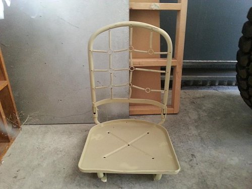

Do the seats bolt onto the cab plate or is there a piece of wood between the seat and cab plate?(mine had wood between)
Also i have seen the fuel tanks on several pictures of the cab 12 that show the fuel caps close to the rear of the cab and other pictures of the fuel caps facing away from the cab. Is there a right way or does it not matter.

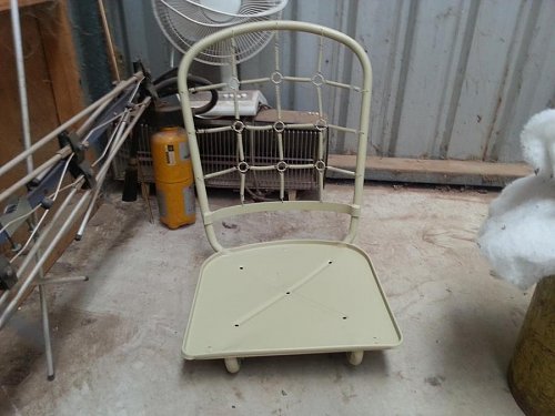

I have two seats that not sure which one is correct for my truck so here are the pictures.
ID:	63528 Click image for larger version

"I have two seats that not sure which one is correct for my truck so here are the pictures"
The Cab 12 had the narrow backed seat fitted as standard: the wide back seat is a 1944 Australian invention. Nothing to say it was not 'retrofitted', but it was not standard for the vehicle.
The comfortable one is the wide back one, of course!
Mike C

I must be missing something - "comfortable" and Blitz seat in the same sentence!
