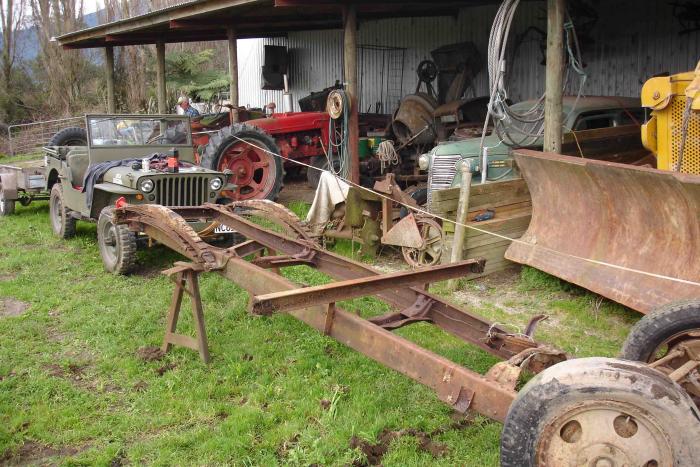

We found that our chassis was not good enough so hunted around for a better one and were surprised to find one with the correct 134.5 inch wheelbase on a nearby farm. Then we did a mockup of the truck for an ANZAC day display at the local RSA, which caused a lot of interest.
Later we attached the front panels to the chassis for a trial assembly in the shed, with the steering column attached. All body panels have been bead-blasted or acid-dipped and have been given six coats of paint (3 coats of primer, two of gloss enamel and one final coat of mat finish).
We are aware of some minor inaccuracies in the shape and width of the front mudguards, but at this stage we are undecided whether to remedy that, as it will be expensive.
Chassis primed (RR).jpg   Steering column attached (RR).jpg   RSA display (RR).jpg   Trial assembly (RR) .jpg   Better chassis found) .jpg

After attaching the seat riser to the floor pan, the next step was to make new "battens" for the rear cab panel. The original ones in pressed steel, "top-hat" section were too rusted and too expensive to buy new, so we used square section steel tube welded to a 50mm wide strip of panel steel. They will be stronger than the original and serve the same purpose.
1 Seat riser & floor pan (RR).jpg   2 Battens on (RR).jpg   3 Battens on (RR).jpg
