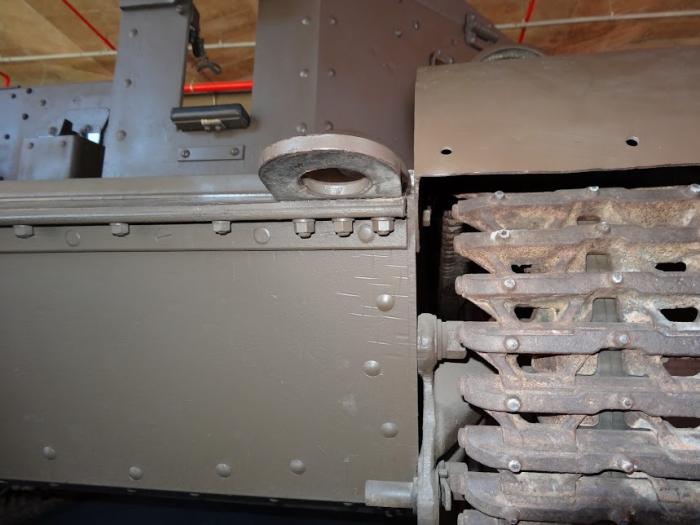

Folks I am just after some close up images of the angle that fits in the gunners firing aperture on the mk1*. Is the angle the same size as the angle used for the rifle rests in the rear compartment ? Does it mount on the inside or the outside of the front armour ?

I can't do measurements, but here are pictures. The High rubber is British, the low one Canadian, how ever I think both steel bits are Canadian (the British stud is pointed?)

yes please and i will fab something up, is it angle iron or bent plate its made from ?
EDIT: - just zoomed in on Lynns pics it appears to be bent plate, where does the stud go ? is there a hole in the armour which I have missed ?

Default NOS nipples
Turn the nipple out on the lathe.
I believe Brian Asbury may have the mounting plate with nipple as NOS.
Remember the fastener backing plate strip, TL 13069 which is on the front of the armour.
