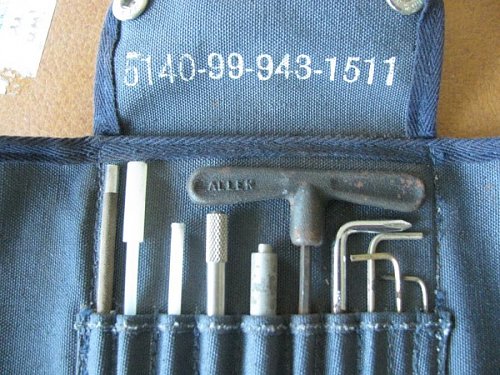

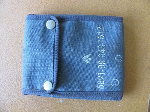

I was looking for something in the shed and found these items I want to know what they are and where do they fit into the Military scene.
First item.
Name:	What are they 004.jpg
Name:	What are they 005.jpg
Name:	What are they 006.jpg
Regards Rick

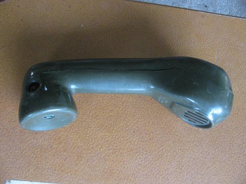

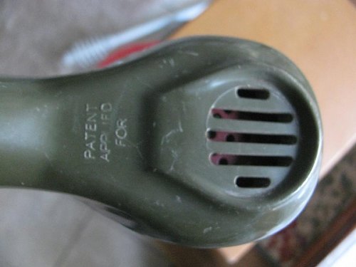

Second Item?
Yes I know it's a telephone hand piece.
Name:	What are they 007.jpg
Name:	What are they 008.jpg
Name:	What are they 009.jpg
Name:	What are they 010.jpg
Regards Rick.

The 5140-99.... stock number is for the pouch itself. The 5821-99-943-1512 is for a "tool kit, electrical equipment". The stock class itself (5821) is for " 5821 - Radio and Television Communication Equipment, Airborne"
Afraid I can't narrow it down any further. The kit is not applicable to North American usage as near as I can see.

This is really interesting, I originally was just wanting to id the two items. Now we have a great listing of NATO numbers etc.
Anyone ID the hand piece?
Thanks Rick.
Old 20-04-14, 02:24
Only that is bears the logo of the Standard Telephone Company, not much else to go on.

Out of curiosity I checked Cencat on this item and it is listed as
Maintenance Kit, Electronic Equipment
Misc Comms Equipment
Listed on Cencat in Apr 1991
Primary users are:
Brazil
Singapore
Italy
Denmark
Still learning to use/search on Cencat, so no more info at hand
