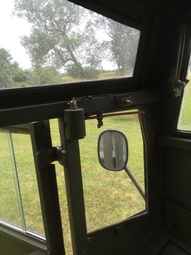

Default mirror bracket
Hi Guys
I have another small question is this the correct mirror bracket for a cab 12 cgt. It appears to be made from a door hinge.
1944 Ariel W/NG
1955 Austin Champ, 04BF45
Old 17-06-14, 23:27
Default Mirror Braket
Hi Niels
Matches the mirror bracket on one of Bill Gregg's http://canadianmilitarypattern.com/R...20color005.jpg
But does not match the other http://canadianmilitarypattern.com/R...20color004.jpg
If you want a larger hi-res version of these photos go to http://canadianmilitarypattern.com/CMP84.htm and click on the image or click the links above.
(note I'll post actual copies of the photo to MLU when I have a moment for archive purpose)
Old 18-06-14, 00:30
Niels V's Avatar
Niels V Niels V is online now
Niels Vegger
Join Date: Feb 2008
Location: Copenhagen, Denmark
Posts: 508
Thanks Phil
Well the one that matches is a Chevrolet and the other is a Ford, so that could be the reason for the difference?

different mirror locations is a Ford/Chev thing
