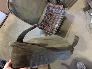

So what goes on top of the spring base, between the cover and the spring? I have a set of NOS seat covers, and a original back cushion, I would think there is a backing that goes on top of the spring base. Anyone have details?

Default Seat composition
Ours had what appears to be kapok contained by hessian over the springs.
They were also a full cover rather than the half one you have there so were reversible.
The sprung seat makes a big difference to the driver experience - much more comfortable than foam.
Pic is upside down for some inexplicable reason!
