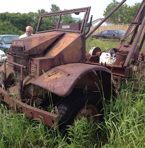

Guys,
I'd always assumed that the final assembly took place at the Ford plant. However, Robert Parker, sent me a series of Lynx pictures that he had collected and in the midst of the pictures are a series outside what I think is the International Harvester plant. The logo below the roof peak appears to be the IH logo.
Peter

  #62
Old 12-05-14, 06:31
Join Date: Apr 2011
Location: Cherry Valley, ON
Posts: 554
Default Latest

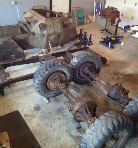

Getting closer to the root of the problem. I am reminded of the old adage - "no matter how large you build your garage, it will never be large enough".
Peter

  #63
Old 12-05-14, 19:01
Peter,
Good to see the old Lynx is now apart and ready for the mating of the hull(?).
I am pretty sure the building is Ford and not IHC. The Servicepub factory photos CD has several shots of the Lynx, but also has shots of other vehicles with the factory as the backdrop. One with a carrier shows a huge FORD sign on top of the building and another well known picture shows (what I presume if the other end of) the building with stacks of FAT and 3 ton bodies waiting for assembly (no Lynx hulls that I can see!)
Back to the discussion of Final assembly....I guess you have final assembly and final testing before delivery to the army...two different things. I presume at least the latter was done by Ford as they were the ones contracted to deliver the vehicles. Personally I would never let someone else do the final test.
  #64

Hello Peter:
I don't think that is the IH Logo showing up near the peak of the roof of the building in Post #61.
To the best of my knowledge, the red and black IH Logo showed up late in the company's life, late 40's early 50's perhaps. Prior to that the logo was a large capital "C" surmounted by a large capital 'H' overtop of which was a large capital 'I', so the company crest was essentially a large circle. I believe that was the logo they operated under in Australia during the war years as well.

Dave,
After taking a closer look, I think that you and Alex are right.
Peter

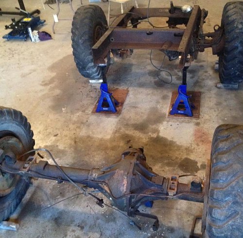

Old 20-05-14, 03:26
Join Date: Apr 2011
Posts: 554
Default Slow but steady

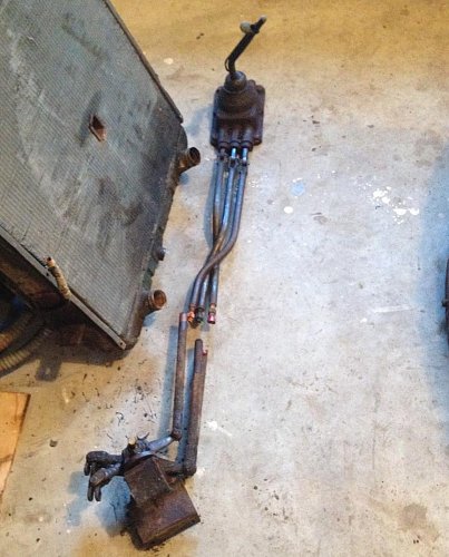

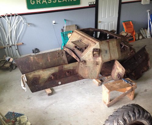

Got to spend a couple of more days in the garage. Removed the transmission and transfer case. Both appear to be in great shape. Transmission shifter linkage will need some work. Rear half of the frame now free and waiting for the front half.
Peter

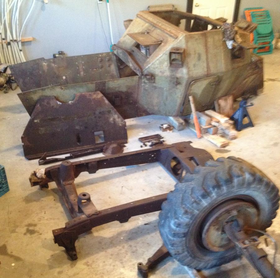

Default Easy part over

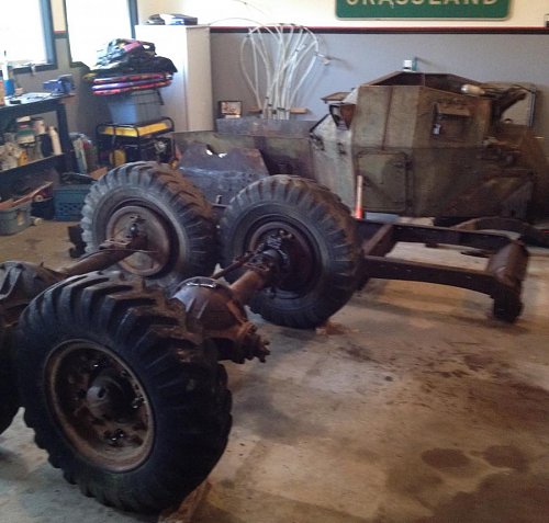

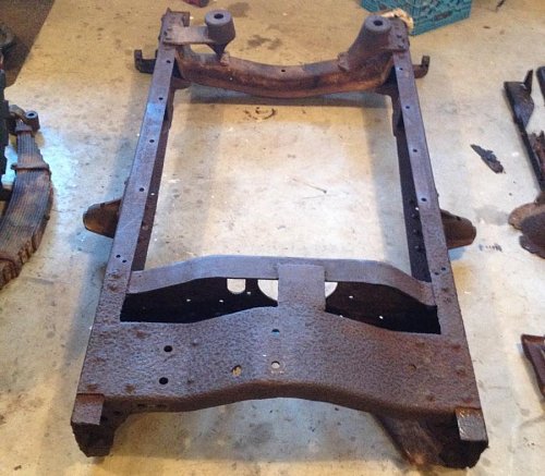

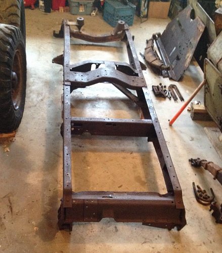

Got the last of the frame separated. The easy part is now over and the fun begins. A good friend has agreed to weld the frame and hull, however that won't take place until mid summer. Lots of time for cleaning, researching and acquiring some of the missing bits and pieces.

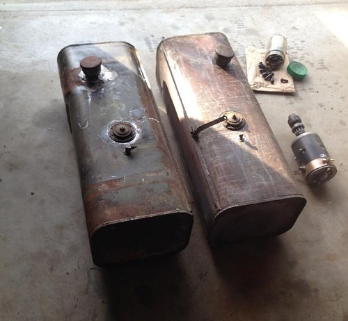

With all the visitors and related trips, the Lynx has not seen much progress. Did get a "care" package from Dirk L. . Between cleaning, rebuilding/repairing and scrounging the inventory of parts is starting to look semi respectable.
Peter

Took some parts in for some machining at a local shop and got another lead on a FGT in the county. This one was even closer to home, must have driven past it a dozen times a year.
Again, this one is being sold as a unit, not being parted out. Unfortunate, since there were quite a few parts that I could use. The FGT is typical in that the rear compartment is missing, but overall the truck is in great shape with some parts stored inside out of the elements.
Peter

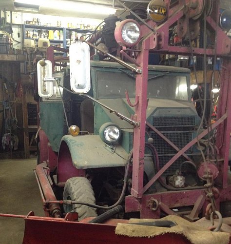

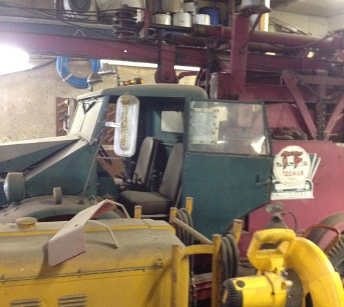

Default Mechanical marvel

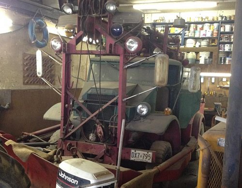

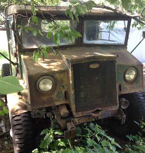

Todays CMP is what I think is a CGT. If I'm wrong please let me know. This one was in the county as well and has been garaged for most of it's life.
This unit was heavily modified to become a combination snow plow and heavy recovery vehicle. The story that I got was that the truck was the creation of a fellow by the name of Lawrence Burford who had a towing business as well as several other enterprises.. It truly belongs in a museum dedicated to people with inventive minds touched by genius.
Name:	2014-08-01 14.22.03 (2).jpg

  #76
Old 02-08-14, 11:37
Peter,

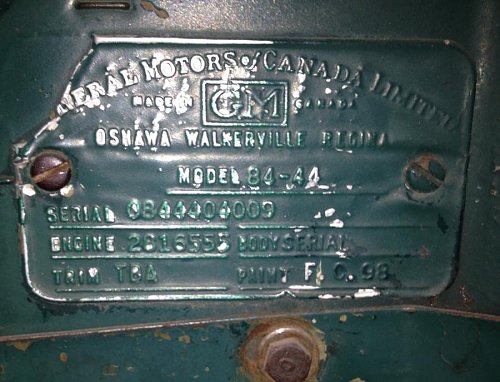

"stock" Windscreen, doors and roof would be out of place if this was a Gun tractor. The cab 11/12 Gun tractors used a body that stretched all the way from the firewall to the back and used unique doors, windscreen and roof.....unlike the 13cab Gun tractors which did use the stock windscreen and doors and had a specific body stretching from just behind the front doors to the back of the vehicle.
The code 8444 shows this is a C15A. From the pictures it looks like a nice example with panelwork in good condition and even with the strip along the roof line! It's hard to see in the pictures, but I think I see rear fenders(?). Retrofitted or original....? could it have been a water tanker?
nice find Peter!

Alex,
Thank you, I was a bit confused since there was a central winch, which I assumed only came with the Gun Tractor. This truck has been so heavily modified, and well done, that it hard to recognize where the original CMP begins or ends. The learning process is an enjoyable part of this enterprise.
Peter
