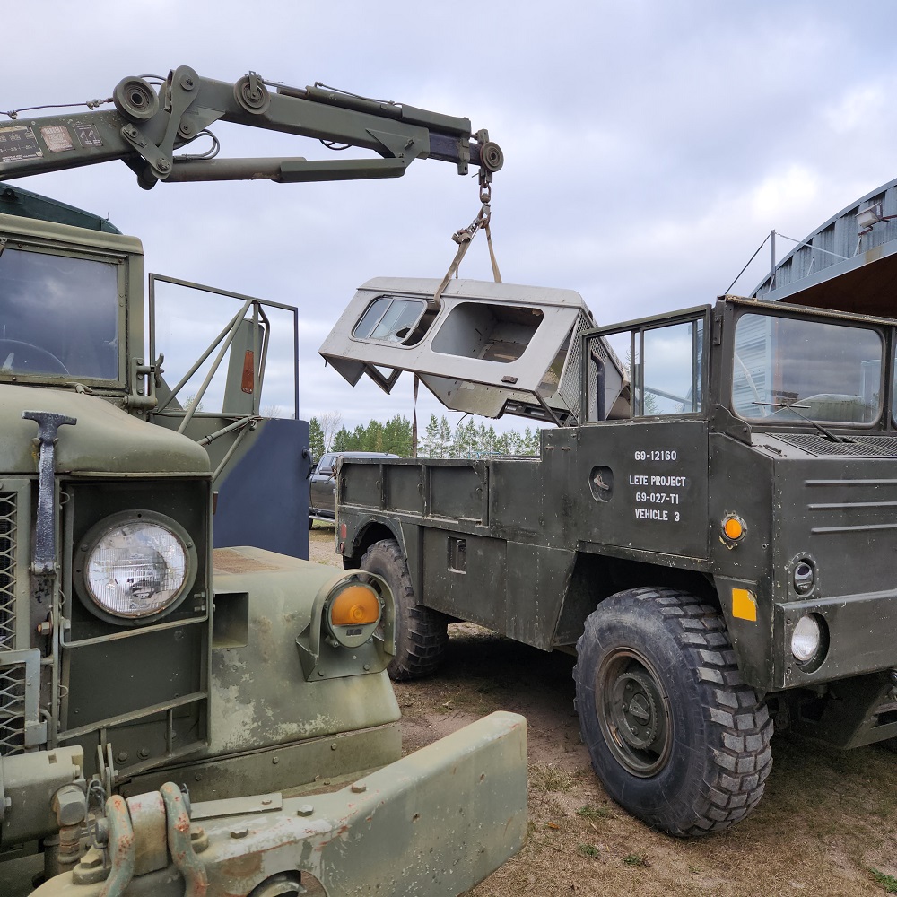

Old 04-10-23, 18:18
This is an older thread, but with some new development. Last night, after dark and in a rainstorm, a clandestine delivery was made to my property here in Manitoba. There were two pieces, one for me and one for my neighbor, but the one for me is something I wave wanted for over 40 years.
RAM serial 3 is now part of my collection, and I want to thank Jack for his stewardship on the truck. I aim to give the same stewardship towards this piece. Once a few minor details are rectified, I aim to make the bows and tarpaulin for both the cargo area and the cab. I have also sourced some new 16.00-20 tires to replace the michelins that are on it now, but that may wait a few months for me to recover from the expenses involved up to this point. I have to head outside soon to see, in the daylight, what I have received.

So with a little more knowledge under my belt, I can offer the following rationalization on these 6 trucks.
Serial no 1: retained by Chrysler and used after the trials ended. Fate unknown
Serial no 2: Borden museum.
Serial no 3: currently with me.
Serial no 4: likely the one destroyed in testing by LETE
Serial no 5: converted to Cummins diesel and for sale out of Calgary. Tan in colour.
Serial no 6: swords and Ploughshares collection
