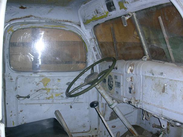

My D15 has been changed to LHD after the war, and the chassis was made longer for better commercial use. This is to be reset to original standard. But even on the frame you can see the yellow color.
Erwin

One of the Dodges at Kingaroy (and Erwin's, too) had the dash below. Comparing it with the '45 dash above, I note some differences.
Did Dodges have Early-Commercial/ Late-Military instrument changes like the Ford and Chev CMP's? When did this changeover take place, around the same time as CMP's?
Old 10-11-04, 10:43
Default Dodge dash
Tony I have been interested in this type of Dodge and the earlier ones ('38-'39) for years (about 30 in fact) both in New Zealand and here in Australia.
All the ones that I have seen have had the same instrument panel and Dash as the Kingaroy trucks.
So the other one pictured is a new one on me as I have never seen this type before. I too would be interested in further information if it becomes availiable.
Cliff

The roof hatch, would that be the same size than my D15 hatch below? If so, do you have a copy/drawing of the exact making?And would you share it;-)))please?
Many thanks for your explanations on the color!
Erwin
