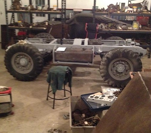

Default Rolling chassis

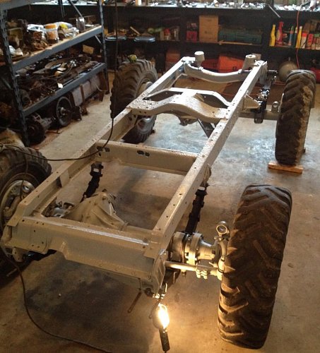

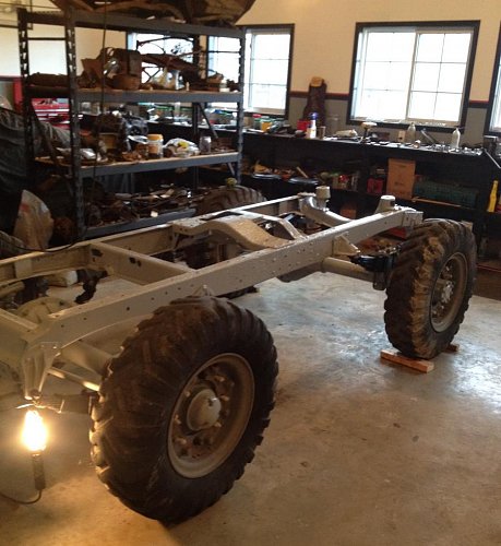

Folks,
Mounted the axles and springs to the frame. Feels quite good considering that they've been apart for over forty years. Had to have a couple of spring u bolts made up, but other than that it's all original components. Satisfying to meet my goal for this year. It will be nice to start adding components and systems, just won't be as dramatic.
May everyone have a great Christmas, Peter

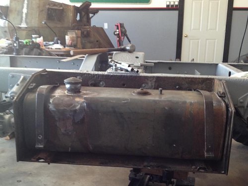

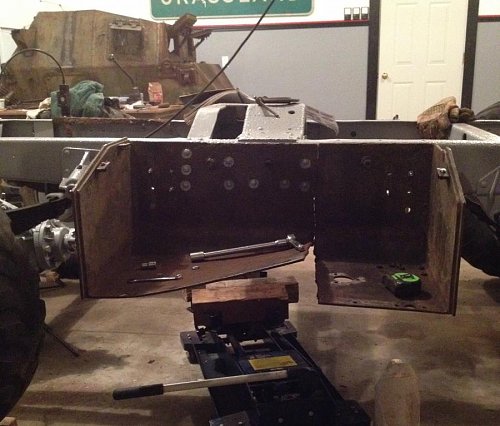

Guys,
Not sure where time disappears to, but it just seems to slip between my fingers. Got the bottom portions of both sponsons for the fuel tanks installed. Testament to both the welders that have worked on my Lynx is the fact that I have yet to ream a single bolt hole anywhere. Everything just bolts up to where it should. The transmission, transfer case and steering box were cleaned up, and mounted. Slowly starting to resemble something semi-respectable.
Peter

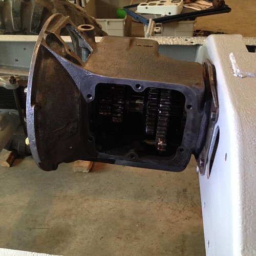

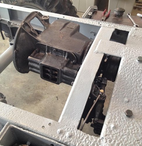

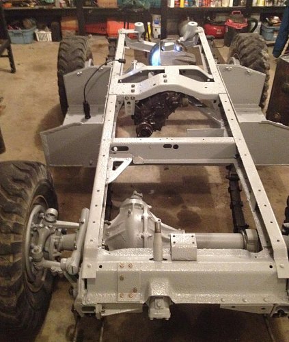

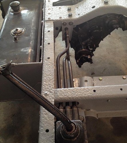

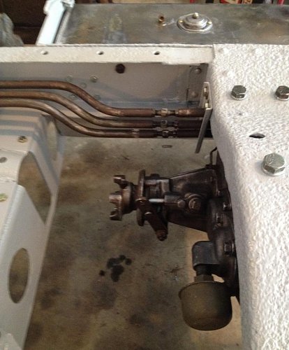

The transmission itself checks out quite well, also the rear shifter unit. My issue is with the front shifter column. I suspect/hope that you are right about the sharing of parts, i.e. the commercial Fords of the same era. The transmission that your friend has, does it still have the shifter column ? any chance of a picture ?
Charlie,
I've attached a couple of pictures of the tranny, linkage and front shifter.
Thanks, Peter

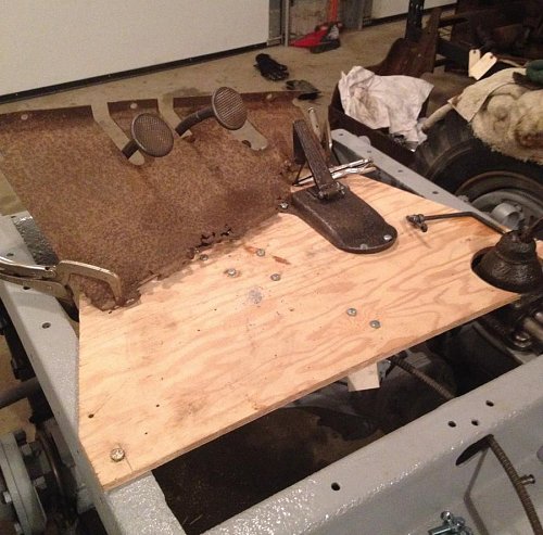

Default Mockup

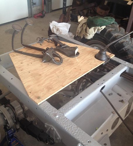

Guys,

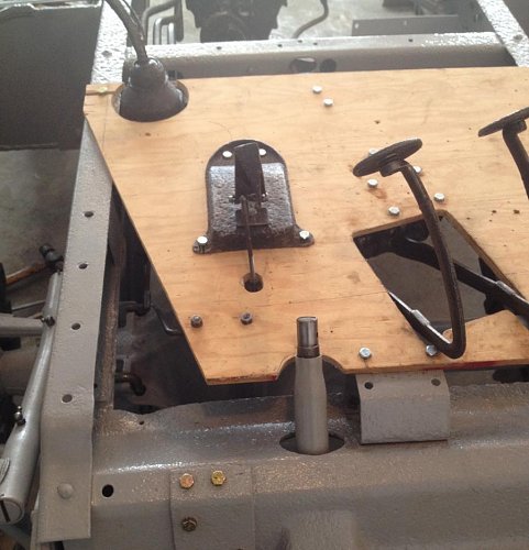

Due to the limited space in the drivers space (ergonomics was not the first priority with CMP designs) I used a chunk of plywood as a template of the front floor to dry fit some of the operators controls and see how all the bits and pieces that I've acquired/ salvaged/ had fabricated, fit together. Highlights what is missing, but still feels like progress.
Peter

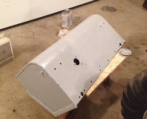

Default First outing
Folks,
She's off for paint.
Peter
