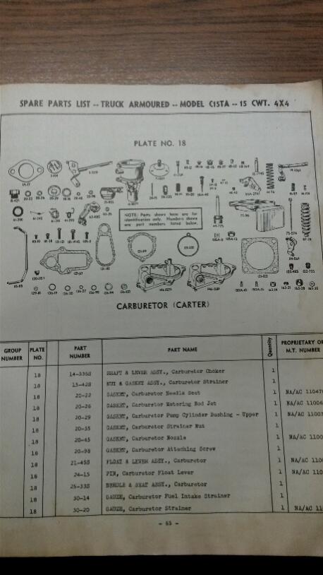

Unfortunately I do not have a lot of time to dig into this, but in a quick look in a Staghound book, they mention that for this type they used the Carter W1 carb. I bet it is adjusted to the bigger 270 engine.
Kind regards,
Stefan

Default C15ta
two more pictures!
In the C15TA (also 270 engine) they used zenith and Carter W1-589S Dustproof this is the one we have for sale.
Stefan
