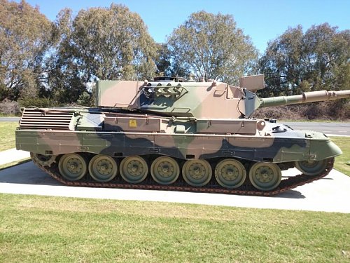

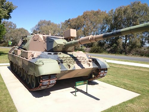

I really like the toys they leave laying around here.
They missed an opportunity by not putting an info plaque on each tank. The only signs say Do Not Climb. Guys at the gate to the base were OK with me taking photos. I promised I would not take any in the direction of the base.

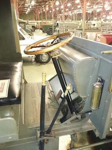

Indeed I did see your Albion, Rick.
ID:	76338 Click image for larger version
ID:	76339 Click image for larger version
ID:	76340 Click image for larger version
A grand old thing it is too. I believe it has missed you badly, as evidenced by the 'tears' that it has wept. You should write more often.

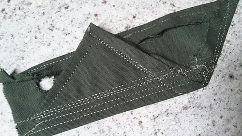

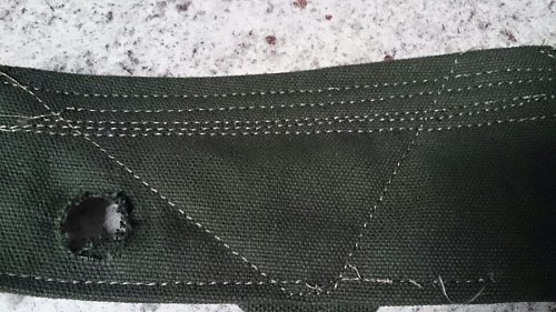

After a number of unforeseen delays, I finally had the chance to setup the sewing machine for my canvas work. Not having any operator or maintenance manual to work from, issues were expected. I was not disappointed. The new bar went in and was set up quite quickly, but because the needle went into the bar slightly shallower, it hit on the bobbin thread case. Another slight adjustment to bar height overcome that, and I made them miss each other by less than a 1mm at closest point of movement. That problem fixed! Next issue was the threading path of the, er, thread. Some trial and error here, because i had forgotten my instructions, AND didn't take a photo of the original path of cotton which the previous owner had kindly left in place for me to see. Some time later, I rediscovered how it should go, and took a photo (also made notes).
The thread I had bought was almost impossible to break with my hands, but incorrect upper thread tension adjustments managed to achieve that nicely. Sometimes it didn't break cleanly. In those instances, partial breakage resulted in a strand of thread getting to the canvas, and most of the thread backing up before entering the needle eye. Getting the adjustment correct solved that problem completely. Fortunately I didn't have to mess with bobbin thread tension / setup at all!

The above photos are my test piece. It is the corner strengthening triangle from a canvas tarpaulin that was given to me by another MLU friend. Thanks Andy! The raggedy hole is where an eyelet used to be. My sewing is sound, but straight lines and presentation still elude me entirely!
Machine still runs too fast for my liking, despite changing motor pulley to smallest available. My clutch control is in embryonic stage, so no help there. When I can afford it, I intend to get a digital motor. Then I can dial the exact speed I want.

The stitch length appears to be very short on your test piece , maybe the machine can be adjusted for that ? re the speed, you can do what I did , add another shaft and pullies , it really slows down the machine and it's a cheap option as well. Mike

Stitch length is at maximum on the test piece. Doesn't look too bad, really. Does make for a strong join, so that's one positive. Tried to rip apart my first join. It's stronger than I am.

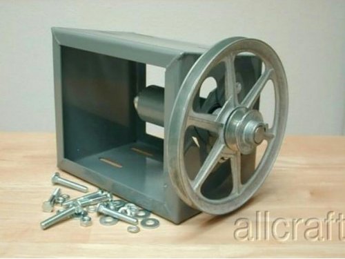

Here's the options on ebay. The sewing machine shops may have other items I don't yet know about. I will look into those in coming days.
The gear reduction option above, is available in USA. Including postage it is $433 AUD.

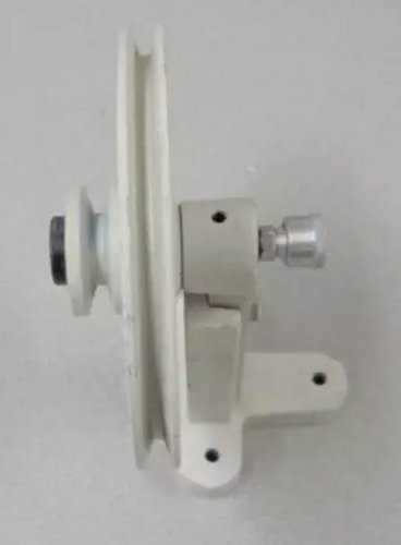

This is a speed reducer similar to what was recently mentioned. It is listed at $32.24 AUD, with Free Postage! It comes from Hong Kong, and I have concerns that this sort of device may damage the motor, as I have not found mention anywhere reputable, indicating this mod is an option. If it was a good option, surely somebody somewhere would be spruking the virtues (other than the seller!) I would be very reluctant to try this device without getting the nod from a qualified electrician who is familiar with all the possible outcomes.

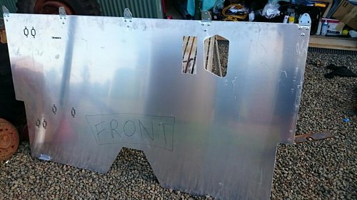

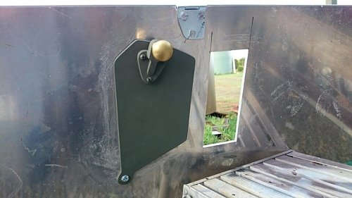

How does the weather always know when to play up? I got the second pair of my 16" wheels back from the local sandblaster on Wednesday, and intended to paint the inner surfaces today. On cue, today was overcast (OK by me.) with slight but transient and unpredictable drizzle from approximately the time I considered getting the wheels out of the workshop. Incidentally, each wheel set cost me only $20 to blast. I think thats a good deal, and unlike the clowns I used in previous years (now gone bum up) they have things finished when they say they will be ready. They don't leave freshly blasted and unprimed parts out in the rain either.

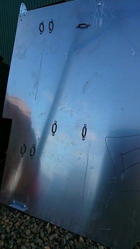

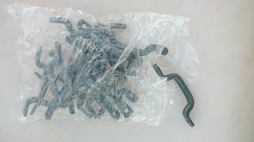

No matter I can't paint today. I have other things to turn to, including adding footman loops to the front of my fake gun shield, and cutting some of the holes needed. I made the sight apeture sliding door many weeks ago, but only now getting around to making the hole in the shield it covers. I still have to attach a couple of pieces of angle before I attempt cutting the barrel aperture. The extra stiffening will be most aporeciated, I can assure you. Although the plate is 6mm thick, it's aluminium, so every bit of anti-wobble is a real good idea. Having to make a lot of compromises with regards to materials available, but should be presentable.
If nothing else, I have now found a use for a large bag of footman loops I got cheap a couple of years ago!

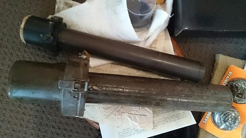

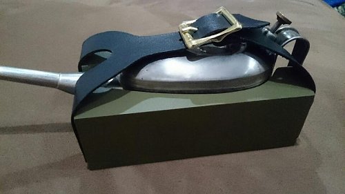

When I come across genuine parts I can afford, I grab em. Always scanning ebay for anything I can use. Recent acquisitions include the telescope and tube you see above, and a genuine 25pdr seat.

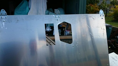

A fellow MLU member took pity and sent me dimensions for the shield. A real 25pdr in a local park gets occasional visits, for me to measure other bits and pieces.
