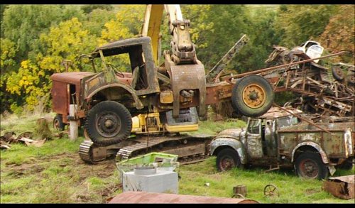

Old 01-12-14, 13:31
Tony Wheeler's Avatar
Join Date: May 2012
Location: Yarra Junction VIC
Posts: 953
Originally Posted by Dave Mills View Post
Have had to replace at least 60% of the mechanical parts due to poor maintenance and repair. Thankfully the donor vehicle supplied all the parts i required. Best $400 i have spent.
Glad to hear it Dave, we didn't get to save much out of that yard so it's good to know the Humber was worth recovering. Like most vehicles there it appears to have been in excellent condition before being parked out in rainy Gippsland for decades. Heartbreaking stuff really.

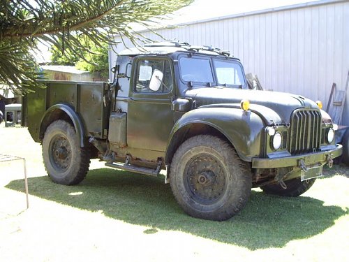

Old 02-12-14, 11:50
Dave Mills Dave Mills is offline
Join Date: Jun 2013
Location: Seymour,Victoria, Australia
Posts: 192
Yes Tony, and I am very grateful for your efforts in saving this vehicle for me from the scrapper, a great job indeed and of course to Euan for recovering it and transporting it to Seymour.
Having a donor vehicle certainly helps with any restoration, a shame to dismantle one to make one but this is how it must be in this day and age and we must make decisions which go against our conscious.
Keeping in mind that 130 only had been purchased by the Aust Govt, they are rare vehicles over here in the land of Aust and in fact world wide as many had been converted to the PIG in the UK, hence the time, money and effort to restore this vehicle is well spent and invested.

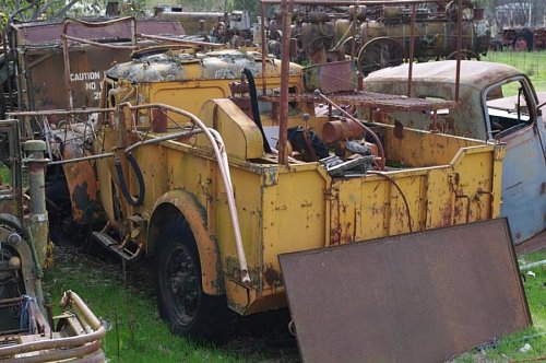

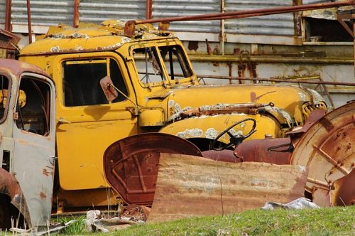

Old 02-12-14, 14:44
Join Date: May 2012
Posts: 953
Absolutely Dave, I couldn't agree more. I've become quite a fan of the Humber through you, and given their extreme rarity in Australia I'm pleased to have been involved in some small way in saving one. I imagine very few of the 130 will survive for posterity, largely because they present an extreme challenge for restorers, in terms of body rust and mechanical complexity. I see them lying around occasionally and they're invariably in bad shape, with no prospects even as a donor vehicle. Hopefully this one at Bookham will find a good home eventually, as it looks to be quite restorable, from a distance at least! Anyway I commend you on your dedication to what is shaping up as extremely high standard resto, and I look forward to seeing it in glorious full gloss DBG!

Old 02-12-14, 22:53
Join Date: Jun 2013
Posts: 192
Bookham, have been through this yard on a Champ Camp and have been up close and personal to the Humber in the pic. No go zone i am afraid as well as the champ sitttng beside it, just to long in the open and rather butchered.
However, there is another couple of gems in that yard, one is a Ferret covered in blackberries still upright on its runflats as auctioned from the army disposal auctions; we managed to prise open a hatch and take a sneek peak inside, it is all there and from memory the crew helmets are still plugged into their sockets. It also was carrying its last units colours still painted on the gaurds.
The other hidden gem is in the top shed in the right hand corner as you look up the hill and it is a Humber FV1600, unmolested and 100% complete as sold from army disposal auctions, Richard Couttes-Smith and myself drooled over it when we found it buried amongst all the wartime jeep canvas stacked in crates sitting on the trailer of a Blitz semi also in the shed and the many, many other vehicles stored undercover in a nice dry environment although covered in inches of dust.
The owner will not sell a thing and it took a lot of talking by others to get all of us scroungers into that yard. It is a shame that this kind of hoarding goes on but each to their own i say. Rich and i both felt that we could have just added fuel, dipped the oil add 24 volts and driven the old girl out of the shed. Of course we would have had to remove the back wall of the shed.
From memory Rich scribbled down the Serial Number of this vehicle.
Dave.

Old 03-12-14, 06:55
Posts: 1,237
Yellow Humber had been converted to a spray unit, would have been quite a useful set up in it's time. We certainly did have a good poke around, plenty to see and cry over, like the DUKW converted to a mobile grain bin... Being the sort of Gentleman that typifies Champ Owners, not a thing came out through the gate except photos.
