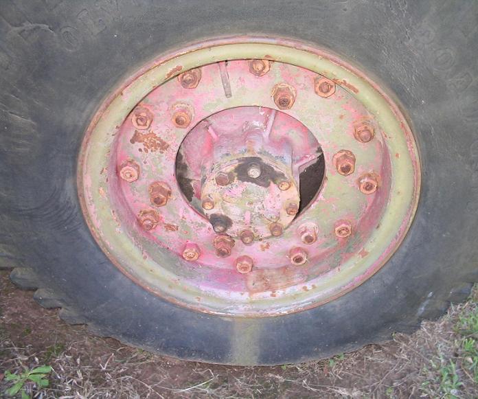

The HUP's are a C8 and had the same rear end as the C8AX, didn't they? Axle made by Clark, quite different to other CMP's?
Old 12-11-04, 09:04
Default Axle shafts and hub
Despite the obvious difference of 6 stud hubs, the actual design of the hub is different to any other CMP. Would the axles from another CMP interchange?

HUP axle shafts are different than common CMP 15, 30 and 60 cwts. There was also early and late differentials with higher and lower gear ratios respectively. The axle shafts should be the same though. Rob, I've got a welded HUP shaft here (at the hub end)that apparently worked, though pretty ugly from the outside. Yours if you want it.
