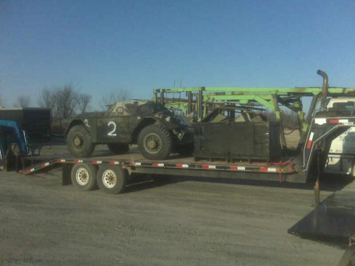

Robin had emailed me on Friday asking me to post these pics, but I was away on a firefighter survival course, so here they are, now...Wilf
ID:	34355 Click image for larger version

Here are some more pictures
PS I can rarely get into this forum, my computers dont like it at all.
Robin
