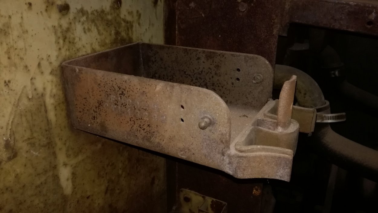

Can anyone help me what were those holes good for? Some kind of rifle mounting? I found something similar in the IWM archive.

The choke cable mounting bracket, mounts on those two holes.
The next two holes take the instruction plate.

Yes. Thank you Lynn.. just found it. Is anybody producing reproduction as I am completely missing the whole thing incl. choke control, instruction plate and the bracket?

The image of the crew washing the carrier shows a MK-I mortar carrier, the gunner side bracket on the divisional wall upper angle iron is one of two for mounting a rifle. A Forum search shows a few images posted by others over the past few years.
I believe you will find your carrier has been modified or updated to the standard MK-I* choke control cable routing installed to suit your Zenith carb. The cable conduit has the correct mounting bracket on the driver side engine head. If you follow the conduit back through the divisional wall you see it running along the right lower hull side, without the later retaining plate installed to keep the conduit against the hull wall. The issue here requiring the later retaining plate was the fact the choke control cable conduit does not travel under the cable cover at the driver right side track guard.
mortar carrier.jpg   moratr carrier rifle bracket .jpg   TL 13 choke cable standard UC type.jpg   choke cable bracket to driver side.jpg   cable protection plate MK-Istar.jpg

Absolutely true. Silly, I wasn't following the cable. Everything is present and well. Still much to learn. Thank you!
