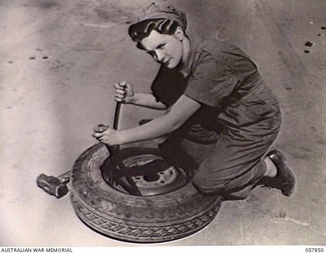

Originally Posted by George McKenzie View Post
I change a lot of tires I counted over 180 tires in my yard the other day. I was 2 1/2 hrs a tire...Those run flat tires are a night mare .... Another word for tire grease is GUNK
Changing tyres can certainly be tedious dirty work. Of course, in wartime you can delegate:
Name:	057850  CAIRNS, QLD. 1943-08-26. MECHANIC JOYCE NIXON OF THE WOMEN'S NATIONAL EMERGENCY LEGION W.jpg
