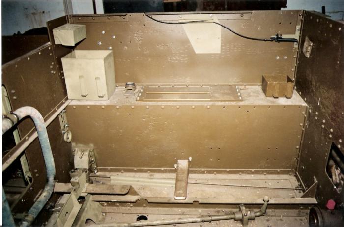

Now that I have a good idea on how the fire extinguisher bracket needs to be made does anyone have some close up pictures of the spare valves and parts case box and dimensions of it as seen in the picture as I need to make that box up unless some one has a spare they want to sell

Must be getting tired as I forgot to ad the picture, It mounts on the right rear mud guard. Just a note as the pictures are from other members carriers.
