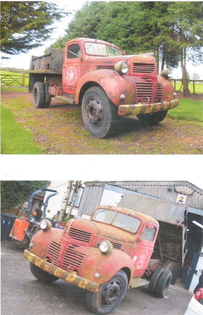

Thanks Gordon. I've got this tipper to inspect for DVLA registration. I just have to check the numbers and it should easily be eligible for an age related number, someone else will have to decide if it's military or not. Ron

Default Well, that's two thousand words right there....
.... if a picture is worth a thousand.
That's not a D15, for a start.
Easy enough though. D60S short wheelbase T110L code tipper ( none of that fancy 'dump' stuff here )
Same cab, same 236 cu in engine as a D15 though it should have a T110-xxxxx code on the cylinder block rather than the T222-xxxxx that would be on a D15.
Chassis rails deeper and thicker, suspension and so on suitably heavier, PTO drive to hydraulics. I'd be surprised if that wasn't all original, only easy item to swap would be the engine. 1941-45 only, military only - note the tow hooks and interchangeable British-pattern wheels. That chassis number will be in the range on the T110L series military manuals and parts lists. I will have it listed somewhere but I'm in Aberdeen and my paperwork is in Falkirk. Feel free to ask again if you meet official resistance, as it were.
There were civilian code T110 trucks, but they were left hand drive only and I've only ever seen one outside the US.

That's fantastic Gordon. I'm trying to help the owner out and will certainly pass on this information. Much appreciated, Ron

With its civilian wheels, might this not have been one of the Dodge tippers supplied to UK Civil Engineering companies engaged in building airfields?
They appear in photos taken at places like Bassingbourne when they were being constructed.
To restore it as one of these tippers might be more authentic than to restore it as a military vehicle.

In the absence of a cab plate ( I'm assuming there wasn't one as no photo ) I'd be looking very hard at that front chassis rail for an eight digit number starting with a 9
While I'm on, it was contemporary practice to mark the chassis PART NUMBER mid wheelbase between the spring hangers with the same size and typeface of stamping, so don't get distracted by that. It is quite easy to distinguish the PART NUMBER stamping as it is very clean, neat, and heavily stamped absolutely square with the chassis, where the CHASSIS NUMBER was stamped quite approximately with a hand held block and usually a lot fainter.

Well Gordon, the wing and front wheel were off when I arrived, which made life easier. I spent an hour with the owner who used his angle grinder with rope wire wheel to completely clean the chassis on that side from cab to bumper, but no other markings came to light, and no indication of it being sanded off.
The truck has previously been used for film work, hence some lack of interest by it's PO on the subject of history or ID, and the reason why it's been painted red over what is clearly army green underneath.
The current owner is very pleased with the information you have provided and the plate that I gave him from Bart Vanderveen's book which should help in his application with DVLA. However I think he will have to go with the T110 number for the chassis number. Regards Ron

Such a lovely truck, but I have to ask about the tipper body......was it replaced at some stage, or strengthened? To me it looks different from the normal 4F pattern dump/tipper body.
Looks like it may be a replacement using the 1.5ton Chev (Yankee Joe) rear tipper body.

That's a standard Budd style dump body. Hoist was normally Heil or Hercules. The length of it means the standard toolbox across the back of the cab has gone too.
Unlike cargo trucks, dump truck tended to keep their bodies, so I'd guess that one has been on there for a good while.
