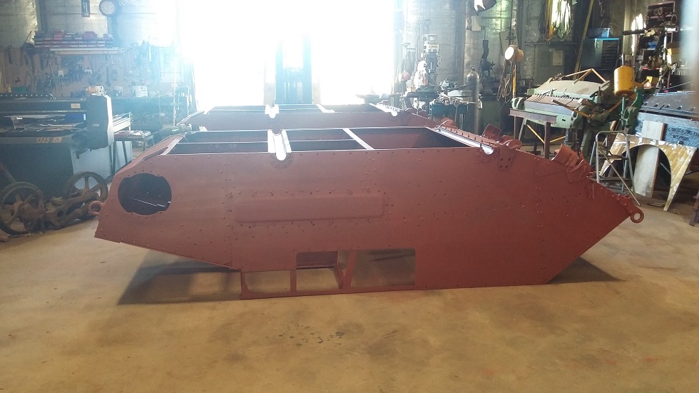

Old 11-06-17, 12:12
colin jones's Avatar
Posts: 1,810
Hi jack, even better now with a coat of primer inside and out and ready for the new floor.
  #222
Old 11-06-17, 12:59
lynx42 lynx42 is online now
Excellent Colin, I see there is still a bit of drilling and cutting to do for the final drive outlets. Keep up the great work.
Regards Rick.
  #223
Old 11-06-17, 13:03
Posts: 1,810
Hi Rick, no that is how it is. One side is different to the other side as they are both original and I have only repaired some cracks.
Colin.
  #224
Old 11-06-17, 13:28
Thanks Colin, shows how much I don't know about them.
