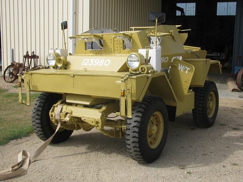

Default RCA Museum Ford Lynx
Photo from the Lynx at the RCA Museum at Shilo.

The Lynx on the left in that photo has the original lid slightly open. The lid opens from the vehicle outwards and has a welded lip along the Lynx hull to stop bits falling behind the bin. I do not think that the left Lynx bin is damaged at all, only open at about 30 degrees.
The fitting of an M3A1 White Scout Car steering wheel would make it a mongrel to drive as the Lynx steering wheel is a lot smaller in diameter, you would bark your knuckles on some sharp edges on the inside of the front armour. (I know that because I have both an M3A1 and a Lynx.)

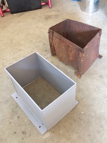

Guys,

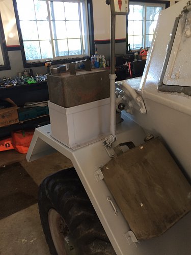

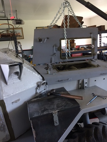

The small stuff is just as satisfying as the bigger stuff. Today was the installation of the new POW holders on the front fenders. It has been quite educational viewing the evolution of the external storage on the various marks of the Lynx. We were fortunate today to have a flight of three replica Neiuport 11s fly into our local airport in Picton. Part of the flight that flew over Vimy ridge as part of the centenary ceremonies,
Peter

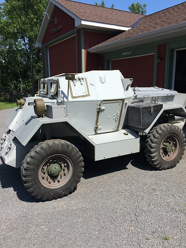

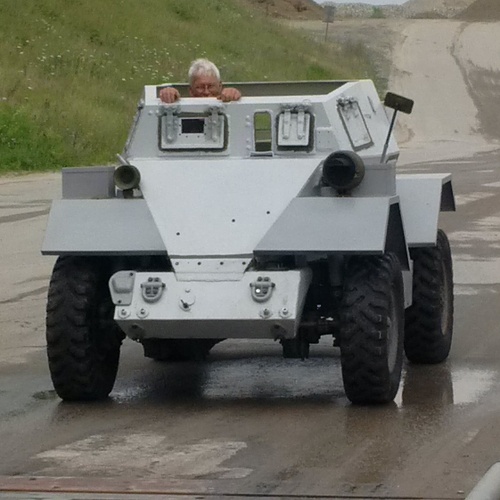

Guys,
The trip to Gananoque was very productive. The Lynx now has a good looking and functional exhaust system thanks to Gerry Foster. He also installed a Pertronix ignition kit and 12V coil. Thanks to the suppression boxes around the distributor and coil they can't be detected. Purists may object, but the Lynx certainly doesn't, starts and runs like a dream.
Peter

Peter,
You were like a little kid with the Lynx yesterday, I am glad you are pleased with the work Gerry has done for you, both the exhaust and the electrical work. It is good to be able to make a recommendation to someone like you and have you happy at the end, managing peoples expectations is important.
FYI The weigh scale was G. Tackaberry & Sons.
Robin Craig

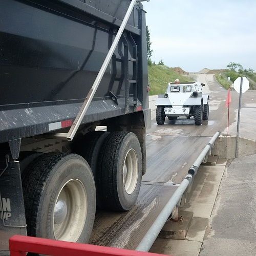

Well done, I did not have to get mine weighed for rego, so I do not know what the actual weight is. You will have an incorrect weight reading Peter, as the engine cover weighs a lot. What did she weigh in at?
Regards Rick.

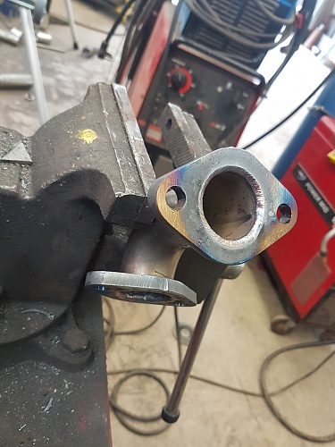

Default Fettling
Rick,
The Lynx weighted in at 3,209 kgs, You are right, when the engine covers, radiator armour and bins are added this will change. I will have her re weighted, and I'll share that with you.

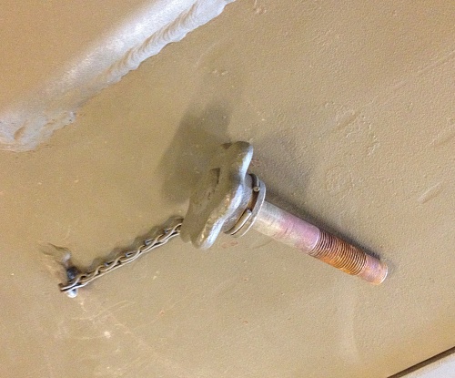

Through some more great MLU networking I was able to find a foundry here in Ontario, that had some of the correct cast handles for the engine cover fasteners. Mine were missing. Great to stroke another item off the list.
Now in the fettling stage. Two steps forward and one back. Have some issues to sort out with my shift lever and linkage. Wonder what the next one will be.
Peter

Thanks for the weight reading Peter, Be interesting to compare a Lynx 1 and a Lynx 11.
Do the foundry have any more screw down handles as I only have one and need three more.
Thanks Rick.

Judging by the price, I think they flipped them from another foundry. I had to cut the shank to length, drill out the centre to accept the stud and then cut a groove to accept the retaining clip. Still, it was worth it to get the correct handles. PM to follow with the details.
Peter

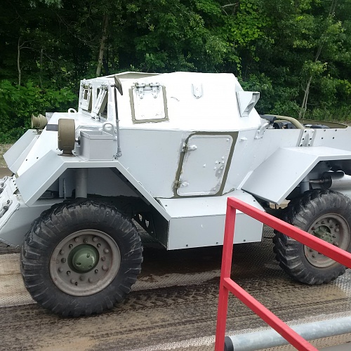

Guys,

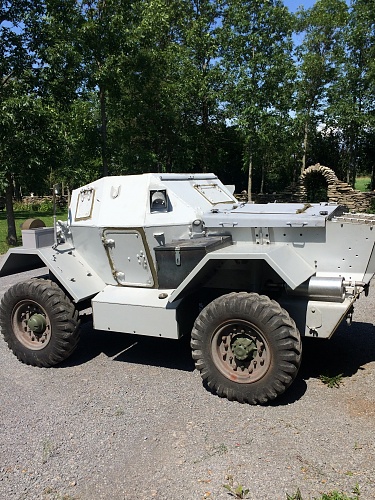

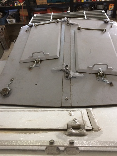

Finally got the engine covers/decks sorted out and installed. While the manual refers to them as the "hood", the weight makes this term seem a bit pale.
Doubt if it is waterproof, but certainly adds to her appearance.
Peter

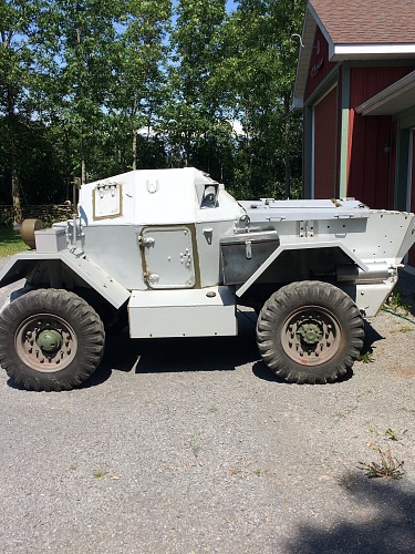

Dave,
Doesn't seem to have altered her stance. Took her for a spin and some pictures, but I can't seem to be able to upload them. Will post them once I figure out whats going on.
Peter

Doesn't seem to have impacted her stance. Next trip to a weight scale will be interesting.
Bruce,
You're right, those words do sound sweet, however each jaunt turns up something that needs to be fixed, adjusted, fettled. However it is progress, and rewarding when I look at where I started with. With luck, my next post will have a YouTube link.
