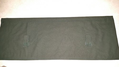

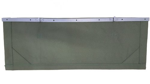

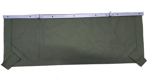

I'm about half way through the canvas curtain for rear window of my green truck.
ID:	85661 Click image for larger version

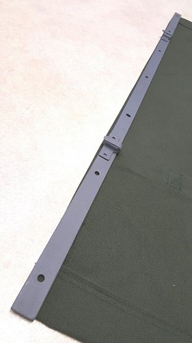

Main part is finished, and the roll-up tabs on back are attached. The steel bar fits the bottom pocket OK. What isn't OK is my sewing. I sew like I weld. Terribly. Took second attempts on two stitch runs, both of which had to be unpicked stitch by stitch. It's a good incentive to get it right first time from then on!

Speaking of dodgy. Look at how straight the top steel piece isn't! It is original, and the joining of two short pieces is obvious. They had to elongate some holes to make it fit the piece behind it. Classic WW2 bodge, to 'keep em rolling'. The two tabs seen above photo are not attached yet. The canvas I used was very coarse and looks right. It did stretch in certain ways, and once that was anticipated I had a better time of working with it. Freys very easily though, so I was grateful that the plans for this piece (supplied by a good friend and fellow MLU chap) called for mostly double layer seams, one way or another.

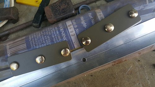

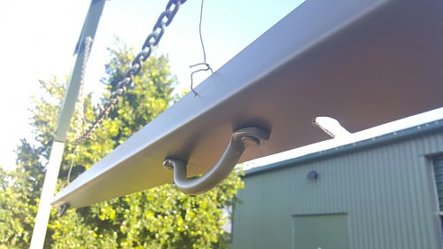

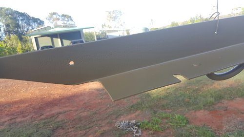

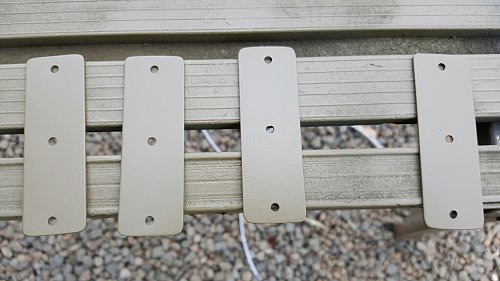

The metal plates that sandwich the diagonal canvas tabs are painted and drying. I may place them next weekend, but will also be attending some duties in readiness for travelling to Bandiana early the following week.

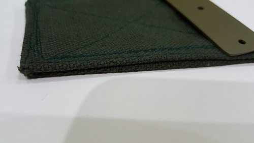

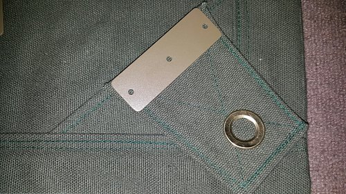

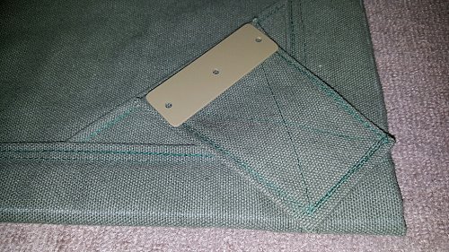

Courtesy of unsatisfactory results first time, a new pair of the corner tabs for my rear window curtain were made this evening.
The first ones I made, like the originals, had a single fold hem only (see left side, following photo). I fully expected real problems with that at some point, and besides, they looked REALLY horrible when folded back to expose underside. Yuck! The one on right hand side of same photo is my second type.
ID:	85715 Click image for larger version
The side view (right hand photo above) illustrates the increased thickness of second attempt. These are basically two like the first ones, sewn back to back and with diagonal stitching for added strength.
After a brief search, I found the eyelets I had bought some time ago for this specific job. They will also be used for the canvas part of the sunshine cab roof.

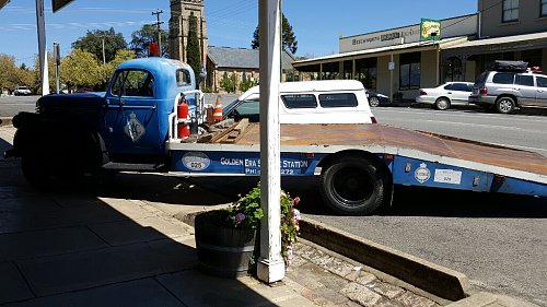

Beechworth has this old Service Station, that ironically doesn't sell fuel, and I'm still unsure if it's a tourist attraction or a real mechanical repairs place. If you are on a diet, or have dental issues, stay the hell away from the sweets shop in Beechworth. It is a sugar nirvana, that has anything ever made in the way of candy. I type this as I sit here scoffing chocolate coated ginger. Ginger is good for helping an upset stomach....and chocolate CAUSES an upset stomach, so the two should cancel each other out, right! We'll see in about 15 min.

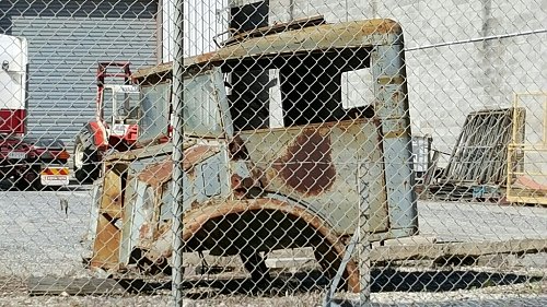

Several weeks ago, Bryce was telling me about a CMP cabin he had seen sitting in the yard of an industrial property in Wodonga. Today I went looking for it.
Amazing where these things show up, isn't it? Apart from a few moderate sized indentations, this lil beauty should come up nicely, and it is quite complete.

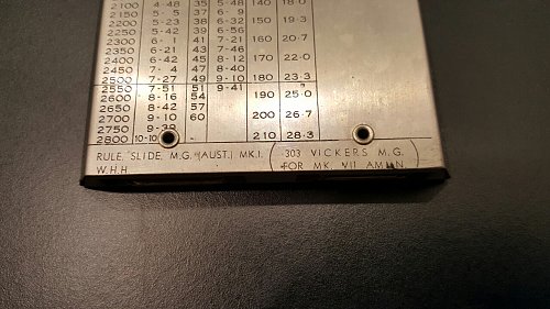

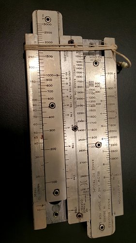

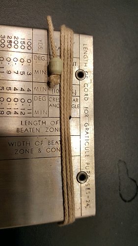

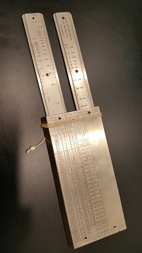

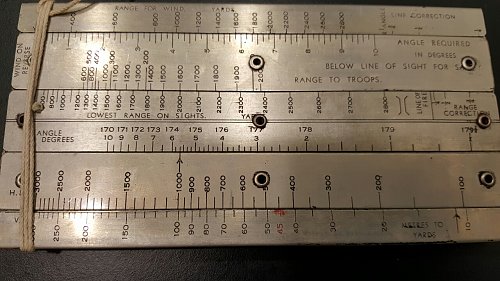

The above item is a aiming/ranging scale of some sort, for a Vickers MG. I didn't set out to find one, but having seen it today, I was taken by the detail in manufacture, and thought it would be a good souvenir of the day, and the trip overall.
ID:	85948Click image for larger version
No idea of manufacture date or exact usage, but I'm sure someone here can enlighten me. It only measures roughly 6" by 3" in main dimensions, and has further information etched onto it's sides and the reverse of each slide. Most intriguing thing is the piece of string attached, which has a small ferrule on the end, and is exactly 24" in length. The length is stated in a location on the device itself, and is indicated for "Graticule Use", whatever that is!
Any additional info on this item, guys?

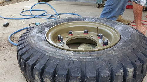

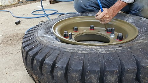

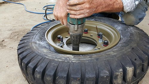

This is how my tyres were fitted to the CMP rims. I must stress the importance of attention to detail and technique. Safety should be first concern, so care must be considered at all times.
First, apply some talcum powder to inner surface of the tyre and all over the tube. Fit tube and liner into tyre. Then brush a liberal amount of suitable tyre fitting grease onto rim halves, from the curve all the way down to where the tyre bead will eventually seat. Apply grease to tyre bead and visible portion of the tube liner. The liner will need to slip freely away as the rim halves come together. We used a lanolin based grease that was easily obtained from local automotive store. "Rubber Grease" was mentioned on the list of suitable uses, on label of the grease tub, so we knew it wouldn't damage rubber. I bought 2 tubs, each being 500grms, and we didn't even use one full tub.

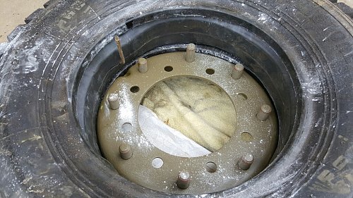

Place tyre and tube over the inner half of wheel, facing upwards. In this photo, you can see the talc powder that got over exterior of the tyre. The tyre seated easiest to inboard wheel half, probably because it was already sitting squarely on the wheel, thanks to the flat surface beneath. Starting now, and at every stage of the fitting, check the liner and tube are located evenly around the tyre and not sticking out anywhere more than should be. This is VITALLY IMPORTANT!

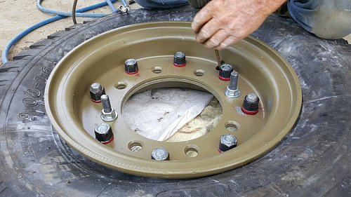

Place the outer half of the wheel over the assembly, in position for the wheel nut holes to align correctly. On some rims, the studs for joining wheel halves were slightly longer, and a CMP wheel nut could be started onto at least one stud, sometimes more than one. Be careful NOT to tighten that/those nuts yet. You don't want to have one side compressed much more than the other! Using two (or more, if you prefer) lengths of thick threaded rod with nut welded to one end, push it through from beneath, with enough excess thread to get another nut (and washer first) on the upper end of the rod. Now, you can start CAREFULLY tightening the threads and whatever wheel nuts went on, in a manner to keep the top wheel half level as possible. You might already find considerable perch can be made at this stage, however it is vitally important to check between the wheel halves, to be absolutely certain the tube and liner are not becoming caught between the wheel halves. This is where the grease to the liner pays for itself. Don't tighten nuts too much at this point. A few revolutions of the nuts will suffice. My friend had a piece of steel which he would continually use to feed between the halves to gauge depth of the liner from the wheel centre edge. Choose something blunt that can poke the liner back in if you suspect it may be getting in the way. Wrap a piece of masking tape around the tool at correct depth needed to ensure liner is clear. Make a habit of checking this every step of the process, and check thoroughly all the way around the wheel. It may save you needing to replace a tube and liner, which is what will be required if you pinch the tube.
Continue to tighten the threaded rods evenly, and at this stage you may get a fair few wheel nuts on. By now the tyre will start to be forced onto the wheel, but it may not go evenly. This is normal. Once all applicable nuts and threaded rod are tightened to the extent that risk of wheel halves seperation has been eliminated, you're just about ready to start inflating the tyre.
There is one more step you should do before putting air into the tyre. REMOVE THE VALVE FROM THE TUBE. You'll find out why shortly. With valve removed, start inflating the tyre, but before you do, check the liner is out of the way again. If you are lucky, the wheel nuts may now have been tightened to the extent that you can't really get anything between the wheels halves. This is OK, provided you have been checking again and again as the nuts were tightened originally. If you DO still have room to check liner, please do so now.
To be continued...
  #1725
Old 29-10-16, 00:03
Default Good show......
Very good description of how to do it right.
Bob C
  #1726
Old 29-10-16, 00:51
Start inflating the tyre, but do so slowly, and do not fully inflate. Pressure should be added in stages, encouraging the tyre bead to seat as you go. It is not unusual for most, but not all, of the bead to go into place with pressure of 10-15psi. If you see the bead begining to seat partially, STOP inflating, wait a little while and watch the unseated bead for signs of very slight movement. You can actually see and hear it moving, but you will need to pay close attention. If movement stops and no further progress after maybe 20-30 seconds, stop here and let the air out again.Releasing pressure at this point will give you chance to do two important things. One, by letting the air out again, the liner and tube will stop trying to 'herniate' between the rim halves (if there is still room enoigh to do so). Secondly, this is where wheel nuts can be tightened further. You may in fact find they can now be tightened very closely to completed torque, but they will always require final tightening with no pressure in the tube later.
Once wheel nuts are tightened as much as possible, resume pressurising the tyre. This time pressure can increase to near amount required for road use. One tyre yesterday required close to 25psi before the last section of bead went into place.
You don't need to increase pressure quickly, in fact it's probably best you don't. The tyre will seat the bead slowly at first, so let it do so at it's own pace. Just watch for movement, and add a little more pressure once movement has stopped for a while. Needless to say, it would be extremely unwise to place fingers between the rim and tyre while this process is happening, so I won't mention that! Make sure you have applied the grease liberally when you started, and keep the work area clean and free from rocks, pebbles, and other grit and contamination. You don't want any of that stuff to stick to the grease and get anywhere it can cause damage to tube at later stage.
Eventually the last section of bead will move into place. Sometimes it will move there gently, other times it may make that last leap with a sudden pop. Who cares how it happens, so long as it does get there eventually.
You're not finished yet. Let the air out again. Hopefully you still have the valve off at this point. With no pressure in tyre, look carefully around the bead edge and check that it is fully seated all the way around. Turn the wheel over and check the rear side bead too. I'll bet it looks fine back there. It seems to seat well, compared to front side. It is possible that there is yet more movement to be achieved, and letting the air out this final time will show you any areas that require more work. If all looks even, tighten all 8 wheel half securing nuts. Now install the valve fully and reinflate to desired road use pressure. That's it....youre done!
I must REALLY stress importance of checking tube and liner are clear of the two wheel halves as you continue to bring them together. It would be quite easy to damage the tube and/or liner as you go. I know this because it's exactly what we did on one of my sets, and that's why I only have 3 of the 4 sets I need. The final one has now been rectified, but this was after I had departed for home, so I need to travel again soon to get the final one! Whatever. I'm just grateful to my friend for all the help he has given me with getting these damned things together. Tyres are still available if anyone needs any. I will be happy to pass on the gentlemans contact number, just send me a PM.
The above information is proved as a description of how my tyres were installed, and it may differ from your requirements. Whatever the case, common sense and forethought should proceed any attempt to duplicate this process.

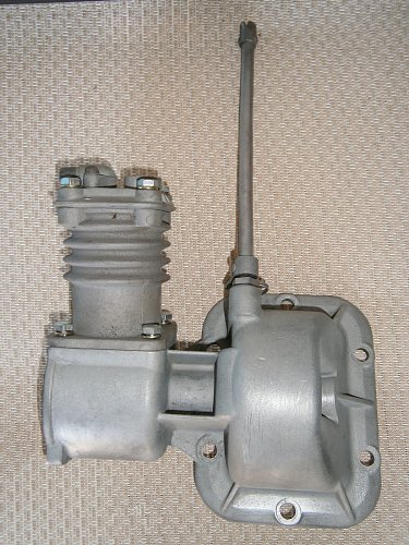

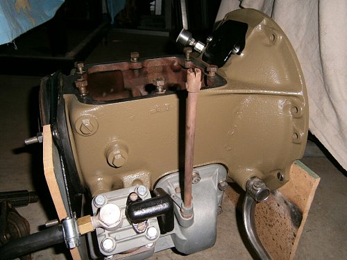

Frank & Marc,

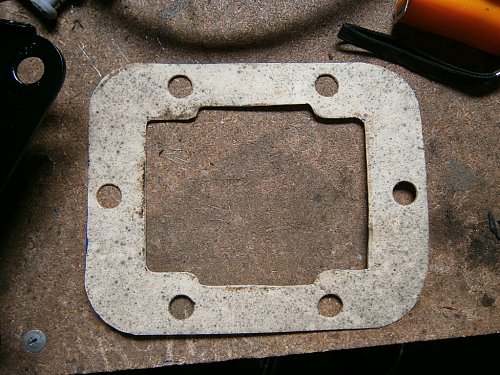

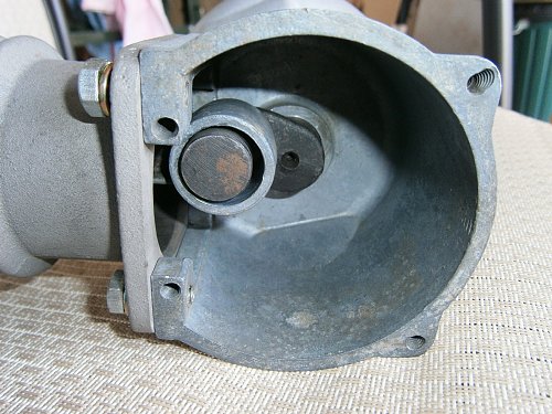

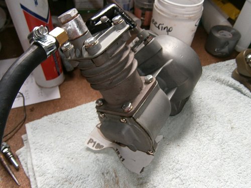

Here are the compressor photos I have at hand. Will continue looking for others, but the following are the sum total right now. If you have any specific questions, post them here. If I don't know the answer, someone will!
The pump should look like this one, and simply bolts onto side of the gearbox by removing a blanking plate.
Name:	Tyre Pump 1.jpg
ID:	86164 Click image for larger version
Name:	Tyre Pump 2.jpg
You use the same bolts which came off, and should only have to make a gasket. Oil for lubrication is shared with the gearbox. You will see in the closeup of the compressor crank, I was missing a bush between connecting rod and crank. If I remember correctly. I got one from my local bearing shop, and had to ream the inside to fit correctly.
Name:	Tyre pump assembled 1.jpg
ID:	86163 Click image for larger version
Let me /us know if you need specific photo of anything in particular.

The rivets to attach the two canvas tabs to my CMP rear curtain, have now arrived.
In order to cover all bases, I have bought three different styles. One is 3mm thick shaft with flat head. The other two are 2.5mm thickness, with one of those having rounded head, the other flat. All three are copper, for ease of forming. I won't need them to be particularly strong. The two pieces of canvas will be invisibly sewn together, with that sewing being entirely (I hope) hidden beneath the metal plates that the rivets will hold together, with one each side of the curtain.
In the interest of overkill, I also have a strong fabric glue that will be used as well.
The rivets were deliberately ordered in excess length. Once I determine how long they actually need to be, I'll whittle em down to size.
If for any reason I bollocks the job, by inability to form the rivets well, or causing damage to the metal joining plates, I have a backup plan. The fasteners for that plan are yet to arrive. Hopefully won't need those.

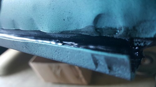

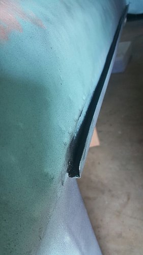

Wanted to paint inside my cab roof today, but only got the seam sealer applied to applicable drip channels.
ID:	86583 Click image for larger version
So it doesn't shrink back when paint is applied, it should be left undisturbed for a couple of days. In my scenario, it will get at least a week. Horrible stuff it is too. Gets everywhere and doesn't come off easily, but has exceptional flexability and lasts long enough to see me out! I used Sikaflex Auto+. It is sandable when dry, and will take top coat paint without need for priming (though I will apply primer x1 coat. Thats just my paranoia talking, because I waht to be absolutely sure it doesn't bleed black through the green finishing coats. Product usage specs say it won't do that, but lots of things happen that shouldn't, right!

Unable to do anything further on the roof today, I painted the panel that holds the canvas cover to front of the roof. Needed to file some/most of the edges of this piece. Several areas were surprisingly sharp, and bearing in mind the canvas will be tightly pulled against the front edge of this panel, I wanted to avoid damage to the canvas when taut. Perhaps paranoia again, but you gotta avoid as many potential threats as practical.
My attempt at using solid copper rivets to secure the tabs on my rear window, were laughable. I don't have the correct size rivet setter, and without the correct tool I would just butcher the job. What you see above is the compromise method of fixing the lower corner tabs that hold the curtain from flapping. More about them once they are in place.
