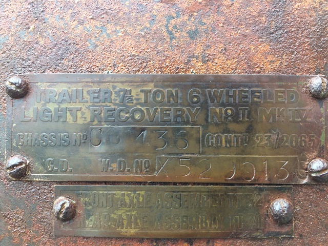

Old 02-07-17, 08:35
Tormod Amlien Tormod Amlien is offline
Join Date: Jun 2017
Location: Norway
Posts: 1
Default Trailer under restoration in Norway
It's great to see others working on these trailers, pictures and information posted as I just started restoring one myself. Does anyone have detailed pictures of the ramps and support feet? And a PDF version of the technical manual/parts list they could share?
Mine is not too bad, but I'm missing ramps, support feet, lights, cranks, hub for spare wheel, spare wheel, crank for winch and the wheel for the brakes. One torsion bar seems to be broken, and the top frame needs some rust repairs and straightening. The inner edges of the bed is cut off to enable narrower vehicles so that need to be fixed as well, and of course the wooden floor is gone. All in all not a bad project, and I've already found two new tires for it.
All possible help is highly appreciated, I got very little knowledge and information about these trailers apart from what I've read here in this forum. Thanks in advance!
