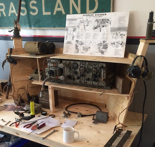

Guys,
Looking for confirmation. I made a plywood mock up of the rear shelves of my Lynx to store a 19 set and some of the associated gear that I got last year. It will probably be several years before it actually goes into the Lynx, but all this talk about canvas covers has me wondering about the one that came with the kit. The number stenciled on the cover is "P.C. 90816C". Can anyone tell me if this is the appropriate cover for my installation?
Thanks, Peter

Old 06-07-17, 01:42
Posts: 4,192
Yes that is the correct cover for the Lynx.
