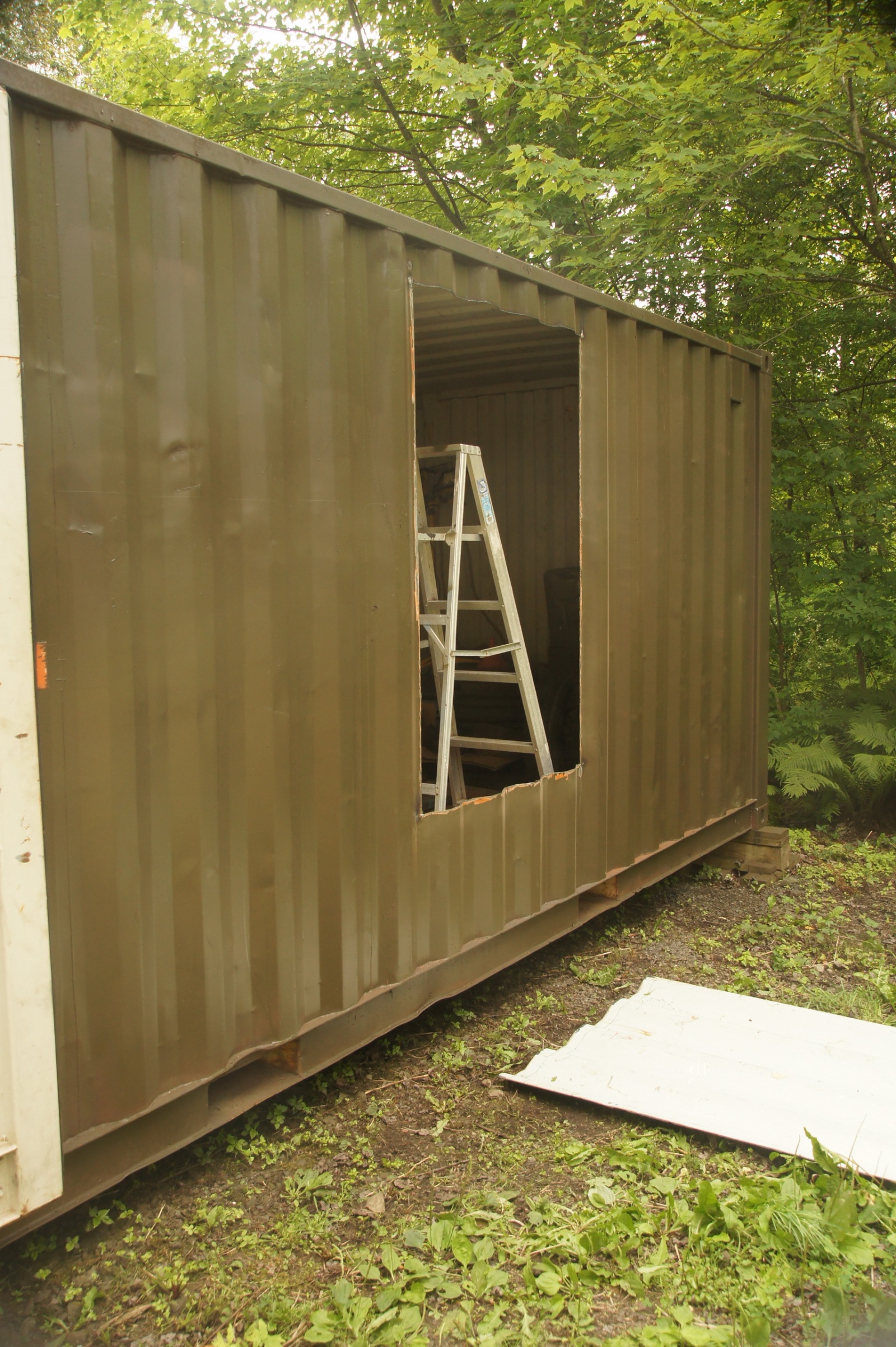

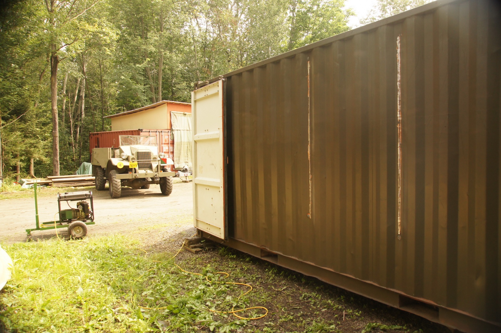

Everyone knows that storing your CMP in a relatively air tight, fire proof and secure space is the ultimate. Well a "sea can" can accomplish all of these BUT it has the disadvantage of being very narrow. Been using a sea can for quite a few years since the cab 11 chassis was mobile under its own power. Crawling over the rear section of the frame was fine for a while but since I have installed the cab and rear cargo box it has become a Yoga exercise everytime I want to take the truck out.
So we designed a door that would open..... inline.... with the driver's door of the cab 11. Measured at least 3 times than cut. The task was complicated by the sea can location 100 meters from the barn and nearest power source. so we used the backup house generator which powered the plasma cutter quite efficiently. The vertical cuts, from the inside, using a guide bar, were by far the easiest. The remaining cuts were done with a hand held 4.5 in. rectifier grinder. It would have been nice to capture the moment the cut out section fell down..... but all hands were on deck and the section quite heavy.
The section of the sea can we removed will be recycled as the door skin. The door frame is a 2 in. square tubing and the door perimeter will also be a 2 in. tubing. The frame is now installed and the door done but will be part of my next posting with photos.
It is amazing how much light gets in the container when that section is removed.
Finally tested the opening by driving the cab 11 back in place. Plenty of room to enter and exit and access to the battery box for the Winter months.
Eventually a small 2 step wooden landing will be built for the benefit of my sore and old back.
Details of progress will follow.
Bob C
The once orange Sea can recently paint with a home blend of multiple leftover oil based paint and resulted in 3 gallons of dark near OD green!!!!

Nice job on the door cut-out Bob. I had to cut several windows and doors in sea cans in Bosnia using oxy acetylene torches, and the warping was incredible.

Rob ......... the plasma reduced the heat signature but nonetheless when the top and bottom cuts were done by hand there was the Odd Boing as some tension released...... and the cut out piece had a definite twist in it.
Not sure what kind of steel alloy they used when fabricating them but it is not easy stuff to weld with a Mig......almost like zinc coated angle iron used in hydro towers.

They do seem to be an odd mix of metal. Whether that is the result of being made in Chine using recycled Hondas, or intentionally made that way to better resist saltwater is the question.

I had the job to put a window in a sea can, for a neighbour, that is being used as a mechanical room at a grain elevator. There is a special alloy used in the construction that is corrosion resistant. I can't recall what it is called but there was a post on the unit saying to repair with the named metal. I used a angle grinder and disc to cut the opening and bolted a metal frame onto the side wall.

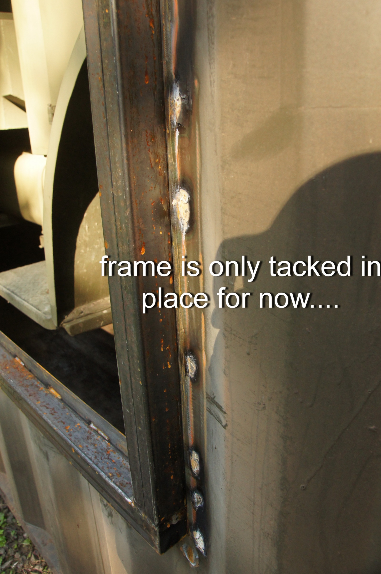

Door is finished..... now toooooo heavy for a one man install.... in fact I think we will use the bucket on the tractor to raise it in place and slip in the hinge pins.
Heavy door so we installed 5 HD hinge...... had a bucket full of them.
Frame is tacked in place and will need a continuous bead of weld to make sure it does not leak.

Looks good. As for doing a full bead weld I'd skip that. Just use that spray sealer for sealing screened for bottomed boats. Surly it should work for sealing some seams that aren't in a sea salt sea environment. Now tell me how many "s" I've used in this post.
Old 14-08-17, 05:34
Posts: 5,259
Default Door..... no s***
Hi Gord
Yes I have seen a similar sticker inside the containers specifying that a certain kind of steel needed to be used for repairs.
Jordan
With the many freeze/thaw cycles in Ottawa I want to make sure no water infiltrates around the frame. Maybe just one welded on one side then caulked will suffice.
Now I just need to salvage the special hinge brackets from the cab 12 that will allow adjustable/folding mirror arms so I can drive in the sea can without having to unbolt the cast rigid mirror arms.
A final coat of paint then voila!!!!!
......and maybe my pictures will come through this time
001DSC06663.jpg   002resizedDSC06665.jpg   003restextDSC06670.jpg   004DSC06671.jpg

Default Finished welding the door frame......
With the house generator hooked up to the MIller 210 It was a more pleasant than using the 110V baby mig I used for the tacking.
Even with the shielding gas turned up for outside welding the steel alloy of the container is a bitch to work with. As I did the outside seam a lot of smoke was generated..... turns out there was water already trapped between the flanges.... and what I though was paint burning off was steam..... and the water made the spattering worst. I blew most of it with the air line and there was enough to form a small puddle on the floor inside.
So decided to do a continuous weld seam on the outside......(sorry Jordan) and will caulk the seam for good measure. The inside got a few more robust tacks for my peace of mind. Noticed that the cold steel of the square tubing is already flash rusting......while the container steel that was ground of any paint for welding still looks shiny!!!!!
Hopefully the door will go on later this week.
