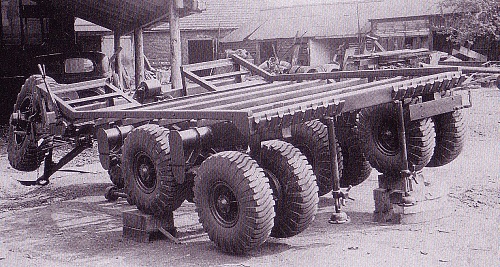

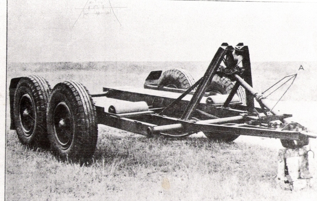

Re the earlier photo, I am still after any details of the trailer behind the AEC. I believe it to be a 5 ton trailer, possibly Cranes, but have no other details other than one photo supplied by Les Freathy of one in what appears to be a farm yard. But I would like to have more technical info if possible.

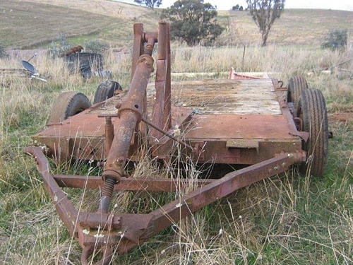

The trailer shown is the Taskers folding trailer, an earlier thread shows an un-restored one somewhere.
Taskers do not seem to have any details, I contacted them and got nothing.
The trailer behind the AEC is the Cranes 5 ton, which I would like to get more details. I have this one photo that was supplied by Les Freathy (thanks), but would love to get some idea of dimensions and tyre sizes.
George.

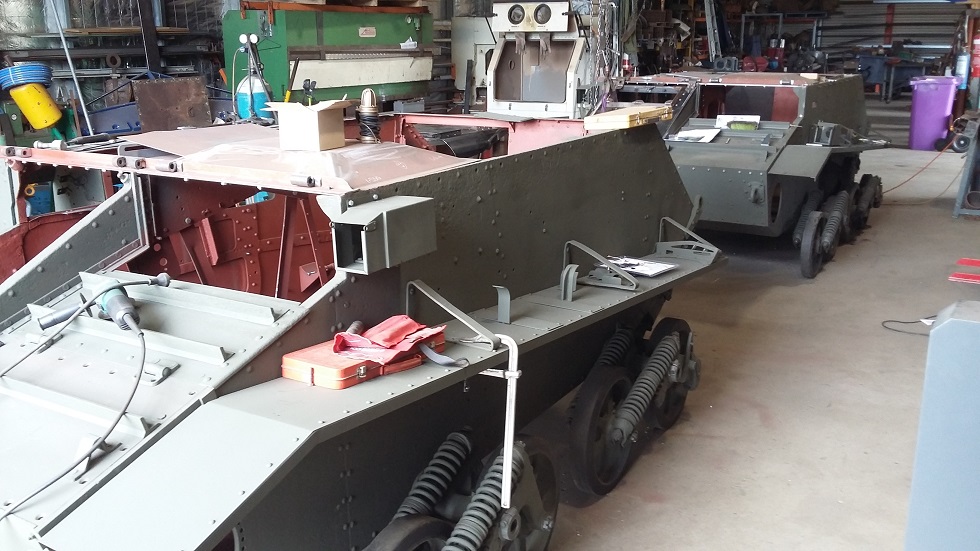

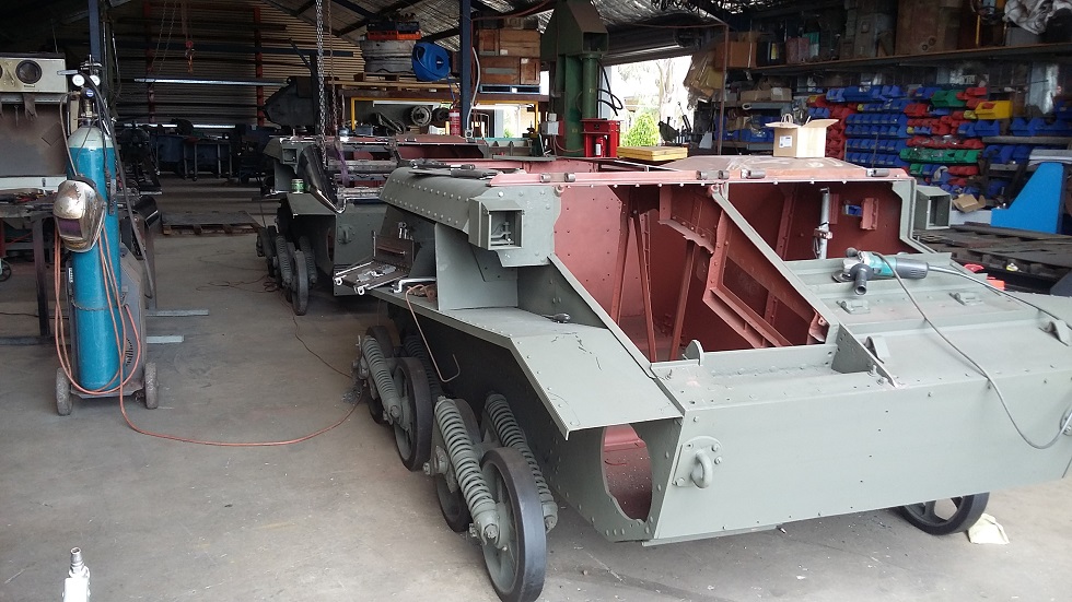

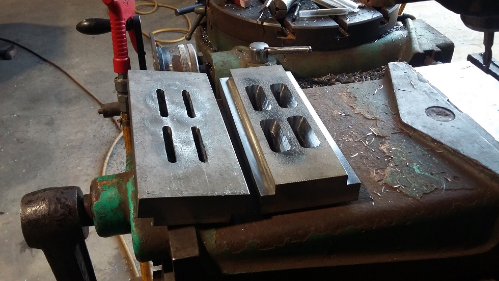

I have relatively good head way on the drivers front hatches
20170921_173429.jpg   20170921_190632.jpg   20170921_190650.jpg   20170922_094919.jpg   20170922_102313.jpg
  #429
Old 23-09-17, 09:19
colin jones's Avatar
Posts: 1,810

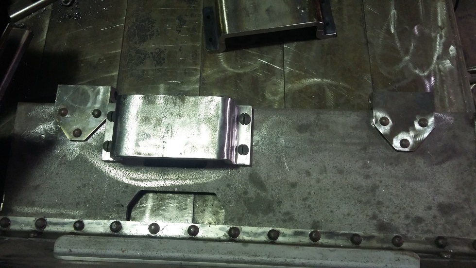

The vision blocks are 1" thick and a full days machining to do both.
20170922_120429.jpg   20170922_125704.jpg   20170922_162702.jpg   20170922_172301.jpg   20170923_074652.jpg

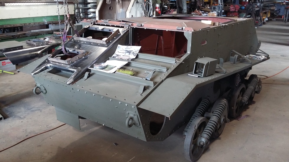

I got quite a lot done in the last week. I made the light brackets and enclosures
20170927_093453.jpg   20170927_131431.jpg   20170927_141024.jpg   20170930_072954.jpg   20170930_073006.jpg
  #433
Old 01-10-17, 11:19
Posts: 1,810
I also replaced the top of the exhaust cover as it was a bit too far gone for my liking.
20170930_073016.jpg   20170930_080208.jpg   20170930_084551.jpg   20170930_090357.jpg   20170930_090421.jpg

Nice work again, Colin. The two tanks sitting there gives your shop a real 'Vickers Production Line' look to it.
Interesting that when I was looking at the photos of the driver's vision ports, my eyes began to water and it made me shiver.
Any word on your engine rebuild to date?

Thank you David, the engine is getting done quite slowly and I need to hurry him up a bit as I'm getting close to wanting to put it in place. I'm going to his workshop tomorrow and take some pictures.
Ryan, thanks for the photo's

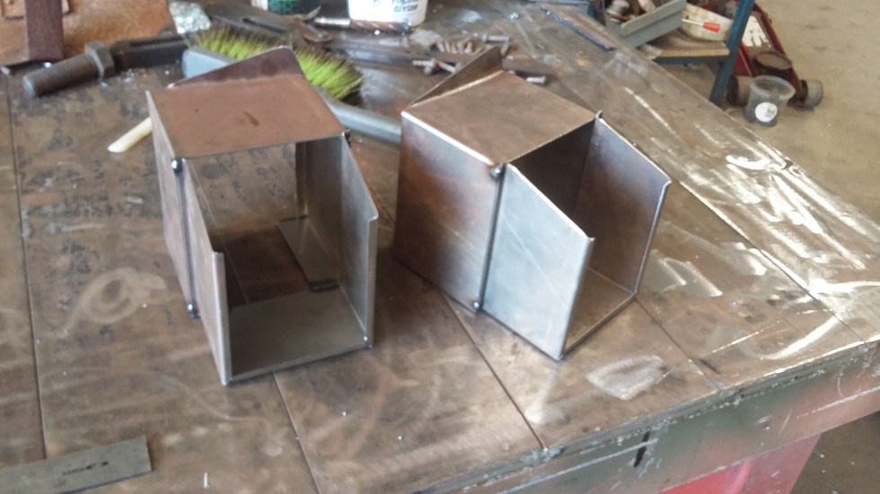

I have now completed the other light bracket and enclosures which incorporates the horn as well.
20171002_090013.jpg   20171002_090629.jpg   20171002_101825.jpg   20171002_112539.jpg   20171002_114803.jpg

I have also started the engine covers.(very slow to get the right angles and things )
20171003_151032.jpg   20171003_151759.jpg   20171003_151821.jpg   20171003_151844.jpg

I've been doing the engine covers and they are very tricky things to make as there is so much involved but again I am doing the both.
20171006_115812.jpg   20171007_090121.jpg   20171007_135350.jpg   20171007_135405.jpg   20171008_171149.jpg

The holes are for the air intake covers that go on top which I still need to make

I still can't believe how much trouble in their design they went to just for an engine cover. I guess they had their reasons.
20171012_125119.jpg   20171012_170248.jpg   20171013_072151.jpg   20171013_180838.jpg   20171013_180853.jpg

Top to bottom on those engine compartment covers, it looks like three openings are present. The top two have their own cover assemblies and the lower one at the handle, looks ducted - up and over a lip of the front hull plate.
Is air from these three openings directed to separate, specific things, like the engine carb, radiator etc., or as Dave Lean suggested, were the designers just out to torment you?

Dave, I don't think they gave a rats bum what happened to these machines after they sold them and having them buried in a dump for years only adds to their charm. No problems for the plasma cutter as I just got a new box of plasma's in.
David, there is actually 4 inlets but what they "ALL" exactly do, I'm not sure yet but no doubt I will find out when that part becomes a priority on the long, long, very long list of things to do.
