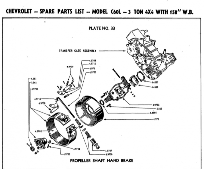

Hi All , I am going to reline my propshalf handbrake on the C60L but i can not find workshop manual type instructions , Has anyone got the strip down pictures , My Chev is a 1945 13 cab General service , I am also looking for a speedo cable for the same lorry , An help would be appreciated , Paul
Old 11-12-17, 17:52
Default Is this what you were looking for
Hi Paul
Is this what you were looking for?
Name:	C60 Parking Brake.jpg
Parts Book
Name:	C60 Parking Brake 2.jpeg
From MB-C2 Manual
Name:	C60 Parking Brake 3.jpeg
Will look for some photos of when I did same job on my C60L.

Hi Phil , Thanks for the quick reply, Those illustrations are just what i needed , While we are in contact could you tell me where the speedo cable meets the gearbox , I had a quick look today but i could not see it . I think you have told me already that you do not know where i can get a new cable , Paul.
Old 11-12-17, 22:12
Default Speedometer Cable
Hi Paul
Speedometer drive is on the front of the transfer case comes off the center bearing cap.
