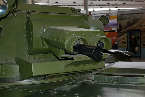

I have been quite busy making the smoke launcher brackets and I need some details of the launcher itself if anyone has one.
Hi Colin,
I had to visit the Tank Museum this week and spotting the Vickers MkVIB I took the attached photo which may help you a little way, when making the smoke launchers.
regards,

I have made those dischargers in the past and have drawings if needed.
Adrian Barrell

Thankyou James, Thank you Richard for the photo and Adrian the drawings would be a great help. While I am on the turrets I think it would be a good time to make them as well.
