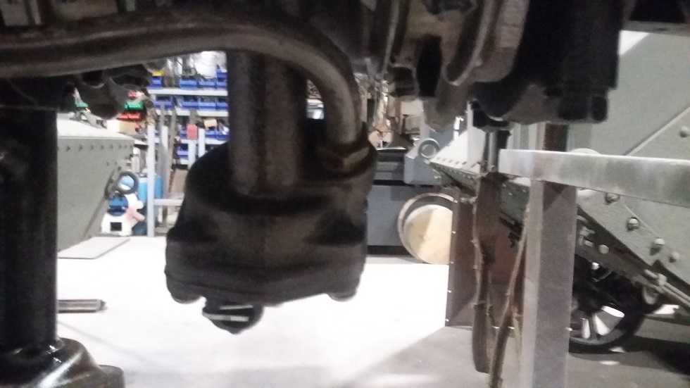

I put the drive train in today for a test but it failed I just wasn't paying attention. The cross tube cover is in the way so some modification is in order. Lucky it's not a big job but I should have measured it before. Once I modify the sump I can then make the engine mounts.

Could I suggest that you make the new sump much wider and with as large a capacity as possible. The oil will get much hotter than it would in a truck as the engine will be working much harder and there is almost no air flow around it. If there is a section of sump with no access to the oil pump it doesn't matter as the oil trapped in it will still slowly mix with the oil 'in use' and will still radiate heat. A few fins welded on the outside would help too.
A great thing with the Chevy engine is that the distributor, plugs, starter and fuel pump are on the side you can get to and the carb should be accessable fairly easily.

The Chev sump looks like it is from a 4x4 truck shaped to clear the front diff. A normal sump from a 4x2 truck will be the same capacity but equal depth throughout its length and likely not so deep overall. I am sure someone on here could give you the measurement.
Changing the sump would also entail changing the oil pick up to suit.

David, I am fortunate that all the parts that need accessing are on the right side and the carb wont be a problem for access either. I certainly had a plan to increase the area of the sump and therefore the oil volume as well. I have come across a problem which I need some help . After cutting the bottom of the sump I realized that the oil pickup is right where the cross tube is and could not be in a worse possible location. In the photos you can see where the pickup is and it must go right to the bottom of the sump. My question is !
Can I move the pick up?
Can I reduce the depth of the pickup?
If it is reduced what problem could result from that?
Could I just use a flexible pickup and relocate to another lower point?
Could I cut the pickup off and just put a new pipe straight from the pump with a small filter on the end?
Does the pickup need to be vertical?
Could it be external as in a remote style?
How is the pick up secured at the top and does it just unscrew?
This is a bit out of my comfort zone so I need some expert advice.
Richard, it is out of a 4x4 blitz and the oil pickup just changed it from a easy mod to a What do I do
