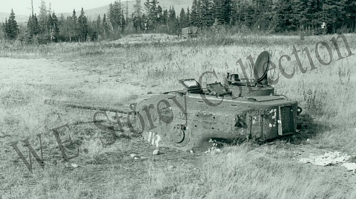

Does anyone know the fate of this Lahr Centurion Mk 11 Gate Guardian?
Attachment 101400
Hi Ed
I am fairly certain the thw that one I posted of in Moncton is the Mk11 that was "guarding" Lahr.

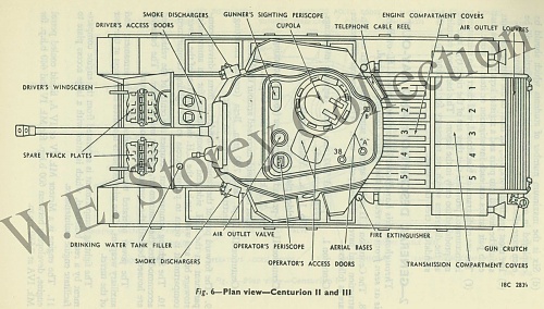

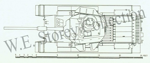

Default Centurion Loader's Hatch
Perhaps the centre section of the turret was removed and reworked during upgrades?

No, those are two different turrets - from new. Almost everything is different in detail. The bins on the sides are superficially similar but actually the whole turret was redisigned.

No, those are two different turrets - from new. ... but actually the whole turret was redisigned.
Sorry I don't know how to put two quotes in from two different posts or I would've included Ed's post as well.
I have information from the website Missing-Lynx which had some good threads about the Centurion. One of the posters, Ossie Orsbourne, had some very good data. For example, the Centurion Mk 3 was built between 1948 and 1956, armed with a 20-pdr and a Besa 7.92mm machine-gun. A total of 2833 were built, with three different turret types. The remainder of the factory built Centurions were 221 Mk 5 from 1956 to 1958 (with four different turrets), 108 Mk 8 (with a new turret design), one Mk 9 and 155 Mk 10 (again, a new turret design). The last Centurion was built in 1962.
What this tells us is that most of the Centurions in service started out as a Mk 3 and were upgraded over time. According to the Centurion information available on Clive Law's Ram Tank website (which I wish someone would resurrect), all of Canada's 334 gun tank Centurions were obtained from 1952 to 1954.
As for turrets, further information given (author unknown) is that the Mk 3 turret initially had a rear escape hatch, then came with the hatch welded and finally without a hatch at all. Canada seems to have purchased later-build Mk 3's with turrets sans the escape hatch.
Finally, found with the turret information, is the cryptic "Conversion to Mk 5 consisted of replacing the Besa coax machine gun with a Browning. Adding a loaders episcope and moving the wireless operators hatch was done at Base Workshops or on rebuild, some never had the hatch modification done. By wireless operator's hatch I presume the quote is referring to what we've been calling the loaders hatch. I don't know if the hatch modification mentioned in the quote is the same one that Don Dingwall is talking about.
What I think is required now is an overhead photograph of every one of Canada's Centurion gun tanks. Especially before and after shots of all those upgraded to Mk 5/2. Shouldn't be hard to get.

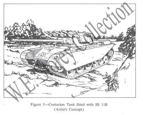

Those are some interesting statistics, here is a 1960 artist's concept drawing of the SS11 B1 mounted on a Centurion.

... here is a 1960 artist's concept drawing of the SS11 B1 mounted on a Centurion.
Yes, that is just like the profile schematic I saw. The missile launchers were mounted on the mantlet.
I read in the Armour Profile (Remember those?)on the Centurion 5 that at one point the Brits thought to mount a Swingfire missile on the mantlet, but that never went forward.
Personally I think its a bad idea to have two main weapon systems on a large vehicle crewed by four. They're busy enough driving, shooting and communicating.

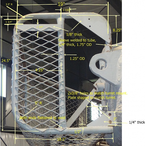

Malcolm
I am on the hunt for a bustle rack for a Centurion, exactly like the one on your tank, haven't had any luck finding one, would you be able to make a few measurements of yours so I could take a crack at re-creating one from scratch? I know it's a lot to ask and you guys are busy out there, but if you had time at some point it would be greatly appreciated

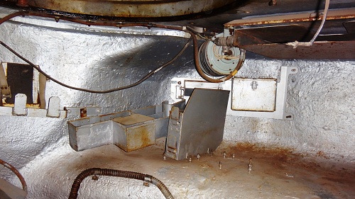

While we have the collected brains of Centurion knowledge focused, are these boxes for a Centurion? Malcolm does your have these? They are for the inside of the turret I am told
Robin, yes, we have one of these at the back of the turret. You can also see to the left two "hooks" for hanging another one.
Strangely heavy construction, not sheet metal like other bins. For something very fragile?
Malcolm

John,
First part of basket. You can start fabbing!
Malcolm

Great news Malcolm, I will donate one for yours and if John doesn't have one or needs one he can have the other one and make a repro off it if he needs more.
Thanks, Robin. I checked the Users' Manual. Those heavy duty containers are for Grenades, Hand, three, for the storage off. Makes sense now.
