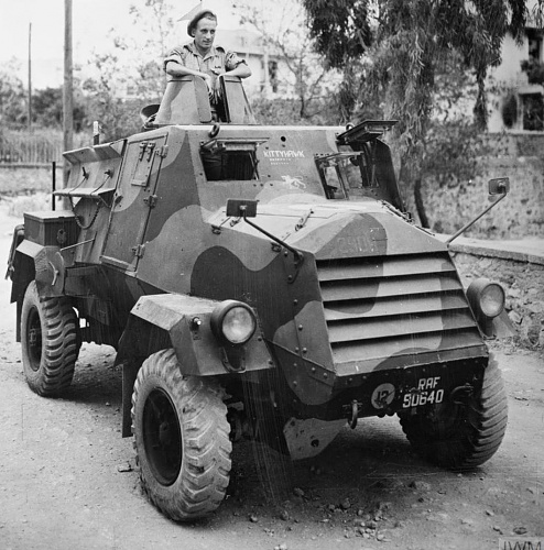

Photo caption IWM (CNA 3672):
Sergeant G H Wingate of No. 2908 Field Squadron RAF Regiment sitting in the turret of an Otter light reconnaissance car in Athens, after being awarded the Military Medal for his actions during an engagement with German troops in northern Greece. On 28 October 1944, 2908 Squadron were pursuing retreating Germans to the Yugoslavian border. An armoured car driven by Sergeant (then Corporal) Wingate was reconnoitering enemy positions at Kozani when it came under fire from a 37mm anti-tank gun and received several direct hits, wounding Wingate and killing his Flight Commander, Flying Officer J H Dennis. Despite the enemy fire and his wounds, Wingate managed to extricate the badly damaged vehicle and reach safety.

Should this photo be in the "Original tyres" thread?
Old 18-11-18, 03:00
Posts: 3,678
Is that a straight diagonal tread pattern on the front left tyre? Don’t think I have ever seen that before.
Old 18-11-18, 04:16
Three of four tires are different, I'd feel better knowing the forth is different again. Two clear headlights instead only one, and no blackout on either. It looks like one British and one Canadian mirror. A white armoured shield over the front diff again? And a bridge class of 12? Really? What do they keep in the back of that thing? Padlock on the rear bin is not the as-issued Corbin.
Old 18-11-18, 05:13
Posts: 7,623
I have one of those tires presently on an artillery rim, courtesy Gordy Falk.
Old 18-11-18, 10:49
Posts: 14,934
Note the name “Kittyhawk” next to the driver’s visor.
