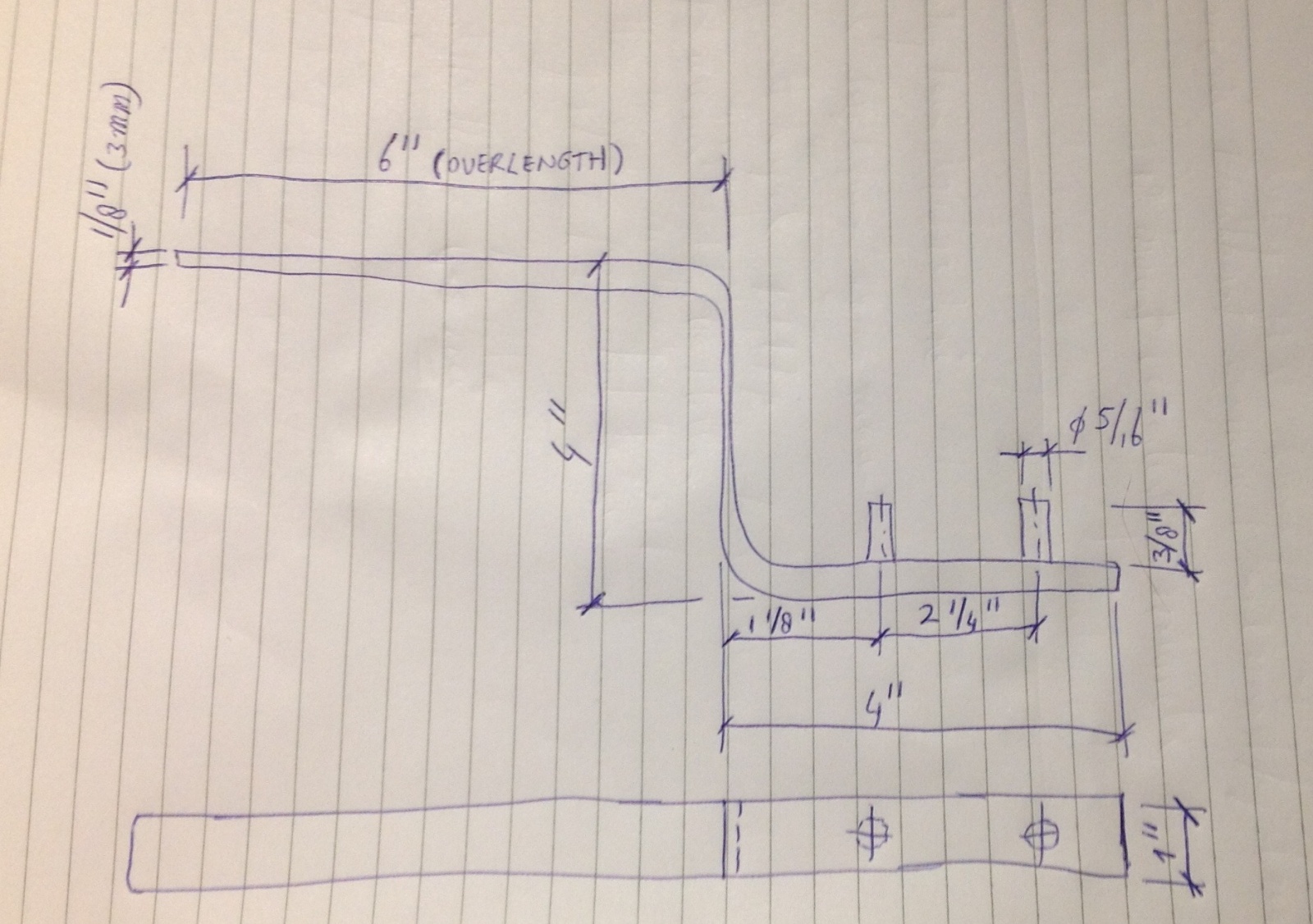

Hi, We have a Staghound on loan and I'm working on setting up the throttle linkages which are out of adjustment.
The pic below is from the manual and shows the throttle linkage "checking gauge". This is an important tool for the initial step of setting the correlation between the hydraulic slave cylinder idler lever mounted on the right hand transmission bell housing and the link rod up to the right hand carb. Not having this makes the setup a bit hit and miss.
Does anyone have one? I don't need the tool but I'd really appreciate a sketch or photo with dimensions.
Thanks,
Malcolm

Try sending a PM to Marco in Holland on MLU. He has done a complete rescue/restoration on an actual XII Manitoba Dragoon’s Staghound, traced the crew and the whole nine yards.

Posts: 267
Default Throttle adjustment checking gauge
I made one which did the job.
Will check dimensions asap.
Marco

Old 14-02-19, 22:56
marco marco is offline
Marco Hogenkamp
Posts: 267
Default Throttle gauge drawing
This is the tool I made.
Old 15-02-19, 05:52
Malcolm Towrie Malcolm Towrie is offline
Location: Whitby, Ontario, Canada
Posts: 306
Fantastic, Marco. I'm very grateful.
