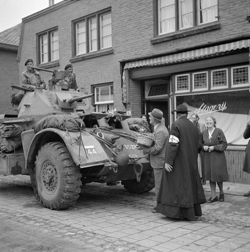

Just that when I see an example like the period photo below, it has me wondering what's going on. Clearly the spacing along the bottom of the 44 is greater than what is above it (excluding the white bar). Unless the numbers were added last and placed so they are centered based on the new height of the marking?

regards,
