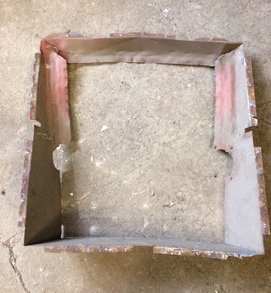

The inner shroud removed.
Does anyone have some drawings or measurements of one? I obviously have some measurements but not for where it was cut down.
