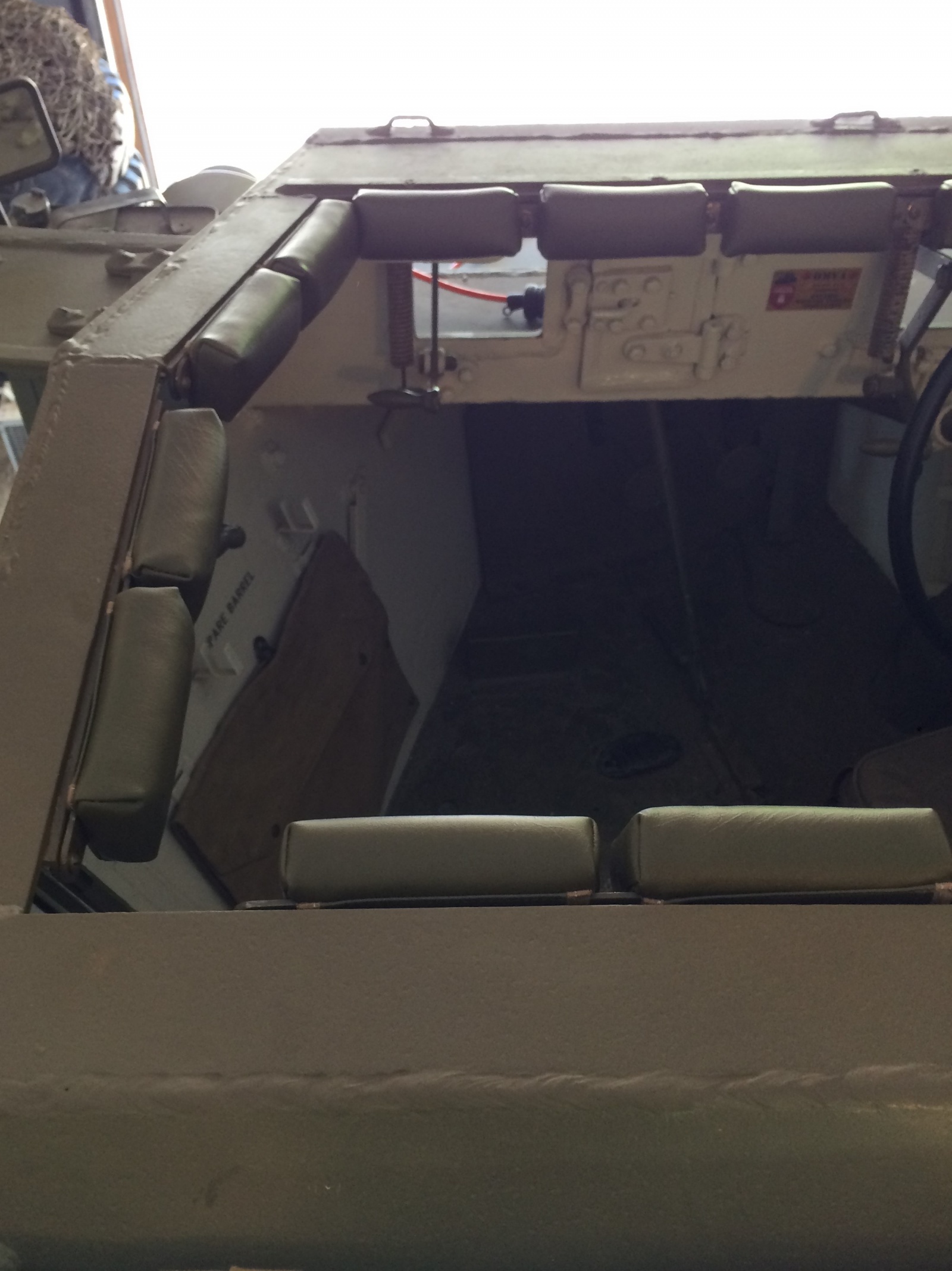

  #727
Old 26-03-19, 03:29
Join Date: Apr 2011
Location: Cherry Valley, ON
Posts: 554
Default Crash Pad Production
Guys,
I continue to be able to find talented fabricators locally for my Lynx project. Steve Burke of All Canadian Canvasworks in Belleville made 20 new crash pads for me. There appear to be two different styles of the crash pads, one the type on the CWM Lynx 11 and the second which I obtained from Stefan Leegwater. I elected to use the one from LWD as the template.
Now to have the supporting angle iron welded to the crew compartment rim and I'll be one step closer.
Peter

Wow Peter, these pads look very nice! Well done!
Stefan

  #733
Old 07-06-19, 04:18
Join Date: Apr 2011
Posts: 554
Default Crash Pads
Guys,
Cleaned up and repainted, then installed the new crash pads. Quite pleased with how they turned out. Aquino here we come.
Peter
