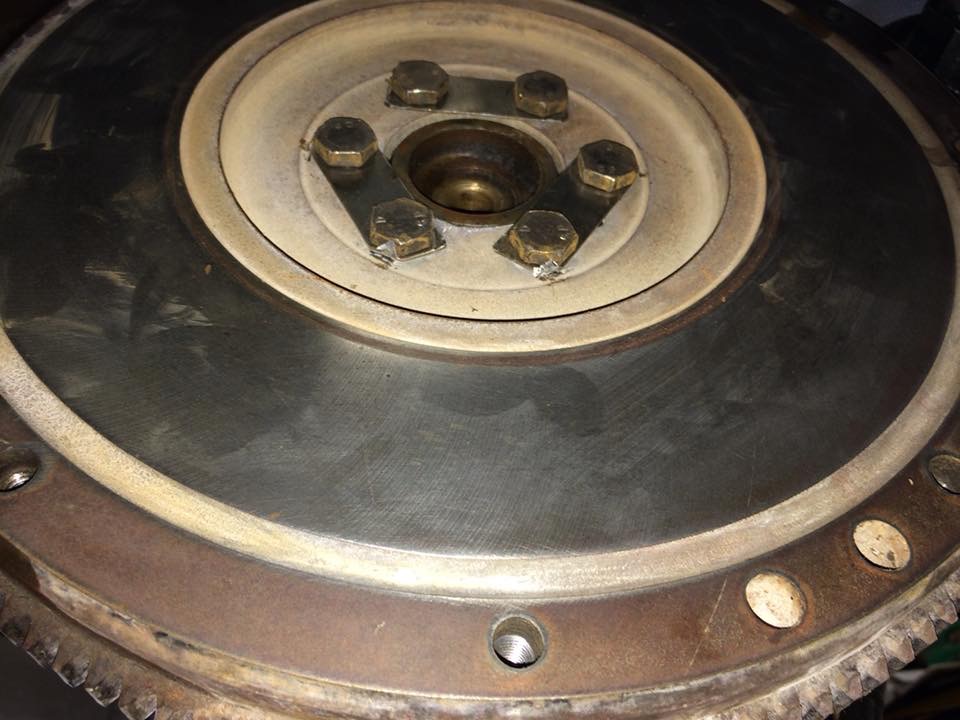

Today’s task was to get the rebuilt transmission mounted to the engine. The resurfaced flywheel went back on after I found the bolt locking tabs. Then the brand new clutch disk and rebuilt pressure plate went in. I picked up a plastic alignment tool off of amazon for pretty cheap. This made the job super easy. Luckily the tool also fits my MB Jeep. Lastly the transmission was lined up and installed. The engine hoist came to the rescue to hold it in position until I could get everything lined up. Also in the mix but I missed taking a picture was the new throw out bearing.

  #676
