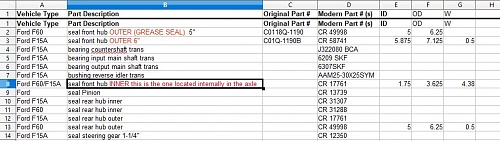

That stupid Spreadsheet in MLU IS incorrect as the seals in the description are reversed:
Seal SKF 49998 is ID=5.0 OD=6.25 Width is 0.5 - This is the correct part number for the F15A Brake Drum Grease seal.
The Seal SKF 45150 is for INSIDE the Diff. ID=4.5 OD=6.25 WIDTH=0.5
SO BEFORE YOU SPEND $52AUD ON THE WRONG SEALS which is the SKF45150, -this is the INNER SEAL IN THE DIFF.
Use the SKF 49998 which is the correct seal.

Ian,
Sorry to read you have been misinformed. Indeed the cross reference from C01Q-1190-B is not SKF/CR 45150 but SKF/CR 49998. Turns out I was wrongly informed and have been sold the wrong seal as as well...
Caveat emptor in bold red below: always check the dimensions, also listed in the spreadsheet. But if it would be of any help, I would be willing to pay for the incorrect seal if you cannot return it.
Thanks for feeding back your learnings into the font of knowledge here at MLU.
See this message in the thread: http://www.mapleleafup.net/forums/sh...430#post254430:
Part number: *C01Q-1190-B
Part name: Seal - front axle hub grease leather oil seal
cross references to SKF 45150: http://www.skfextranet.com/catalogs/...il.asp?s=45150 which is a modern Nitrile seal.
To make sure, remove the old seal and check the following measurements:
OD: 6.25"/ 159,8 mm
ID: 4.5"/ 120 mm
If your old seal measures up to this, contact your nearest auto parts center and order SKF 45150. If they don't stock SKF they will be able to cross reference it to another brand.

Ian,
I added the dimensions and made my own spreadsheet to avoid further confusion. They're NOT on the original spreadsheet which is seriously incorrect. Hence a lot of confusion for people over the years.

If I go back through the releated threads I see the correct info was there, but I did not help by muddling it up. The sheet clearly shows C01Q-1190B to be a 5" seal and part number 49998.
I am inviting you to share your updated spreadheet, on the thread "Modern part numbers for CMPs", to add to the body of knowledge on MLU. Indeed the original spreadsheet was not without faults, but this is work in progress, each MLU member going back and forth finding out the correct modern replacements.
