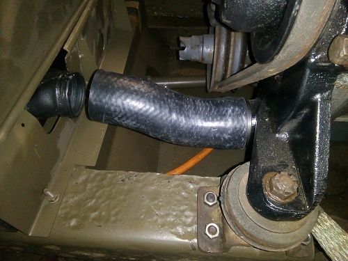

One disadvantage of the new type of single pulley water pump is that the output to the radiator bottom hose is shorter than the original and the special shaped bottom hose is too short to make the gap between the radiator and pump.

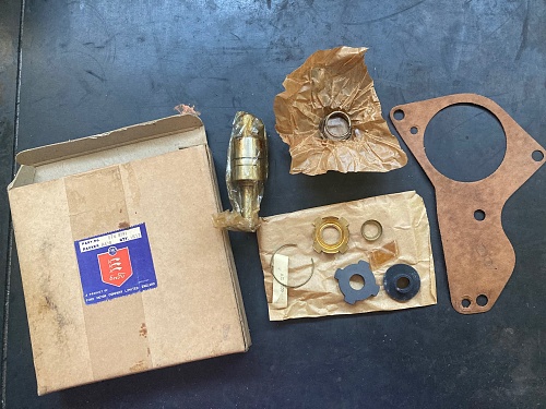

Default Ford water pump kit, part no. ET6 8591
Ford water pump kit, part no. ET6 8591 - "a product of Ford Motor Co Ltd England".
The ET6 denotes it is a spare for the Fordson Thames ET6 Trader. As far as I can see these parts fit the Ford V8 engine as fitted in CMP trucks.
ID:	124826 Click image for larger version
